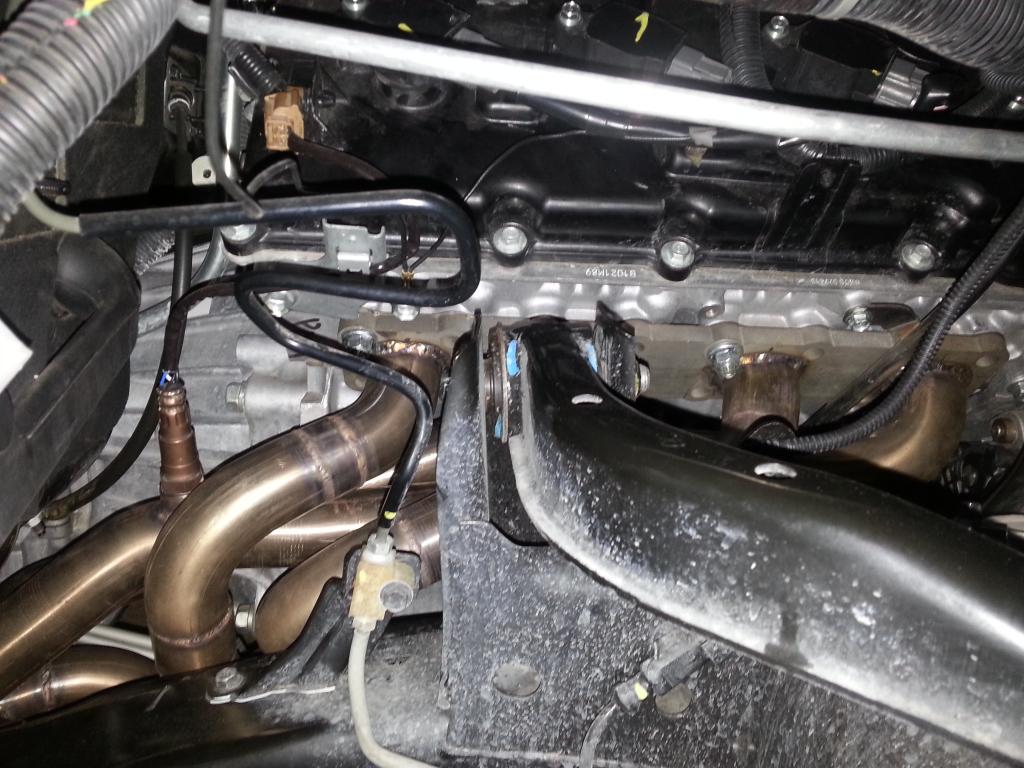

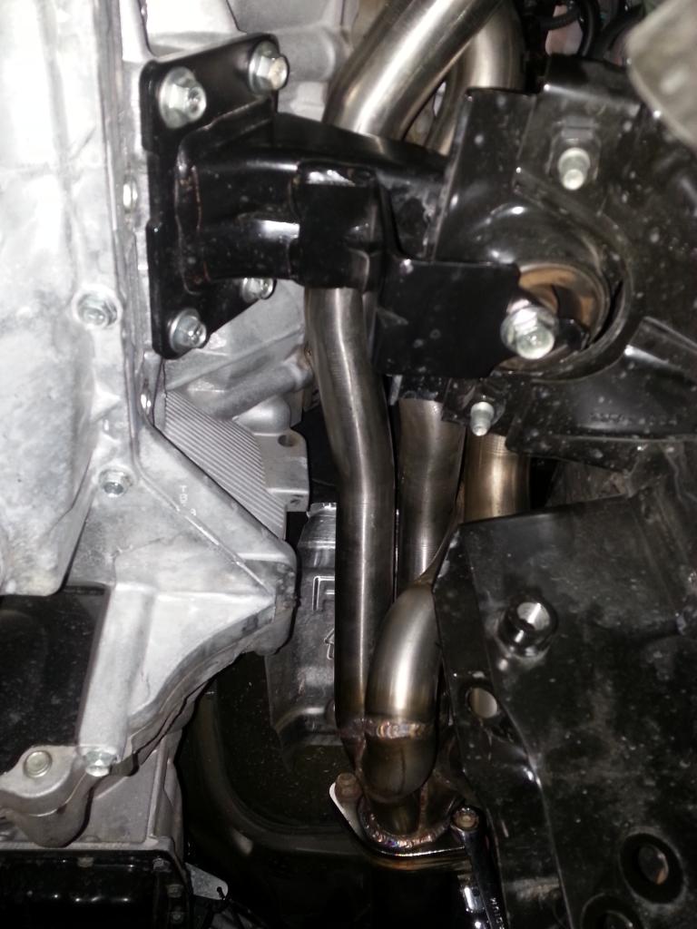

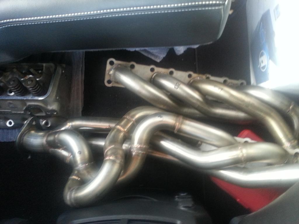

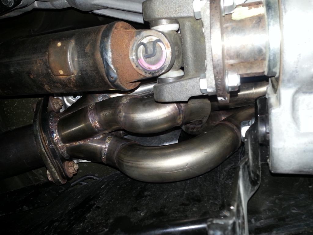

My 2014 has headers on it now and tuned and runs its *** off on motor. I ran a 0-80 run quicker in 100*F after headers than I did in 40*F weather prior to them. I have also sprayed it with a 100 shot a few times and have serious doubts about the Jatco holding up, so I have not sprayed it lately. May end up pulling the bottle off so I don't tear something up.

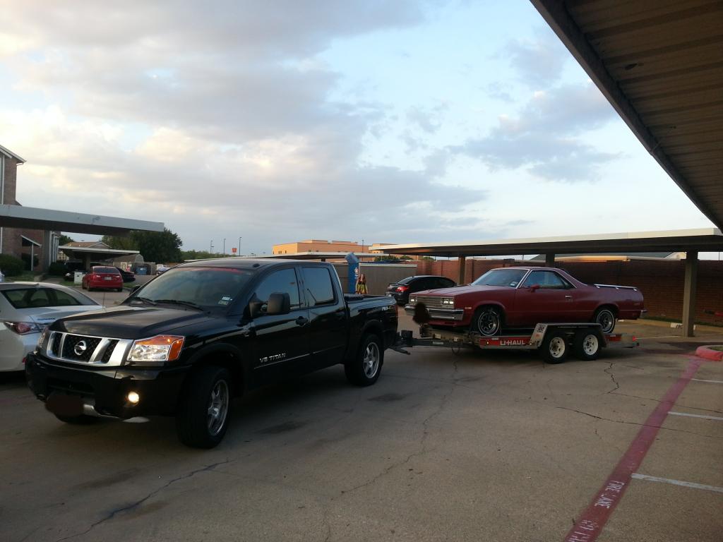

Post headers the thing is annoyingly loud with the catless setup and Nismo exhaust. Will be changing that up soon. Mileage is up 1-1.5 mpg around town. I had to put more than 10% more fuel in the tune when under load/open throttle. Torque is also WAY up. Pulled a car for about 250 miles last weekend and didn't miss a beat. Power was smooth as can be towing at 70-75 mph.

Damn those headers had to add some serious horsepower. Can't wait to see the updated dyno sheet and figure out what forum you copy it from. Its like hide and seek over the interwebz.

I have nothing to say but adding a vibrant ultra quiet resonator AFTER the muffler on nissans will take some drone away. Other vehicles tend to like them before the muffler to act like a cat converter.

PRT owner Steve gained nearly 30 HP at the tires on a 2004 that was only making 250 RWHP to start with. The newer trucks with variable intake cam timing have bigger cams and intake manifolds with larger ports and make alot more power in stock form, despite having the same restrictive manifold design. Would not expect less than a 33-35 RWHP gain on the more powerful newer engines.

Stock cat-back and muffler back on the truck and still have some CIS and drone at moderate throttle and 2,500-3,500 rpm. Stock muffler is very throaty with the long tubes.
Actually kicked VDC in launching in 4-hi. Spun the front tire enough to make the steering wheel jerk and the ecu cut power.
Can't wait for some cooler weather, 97*F, over 3,600 da, and 130-150*F IATs.
