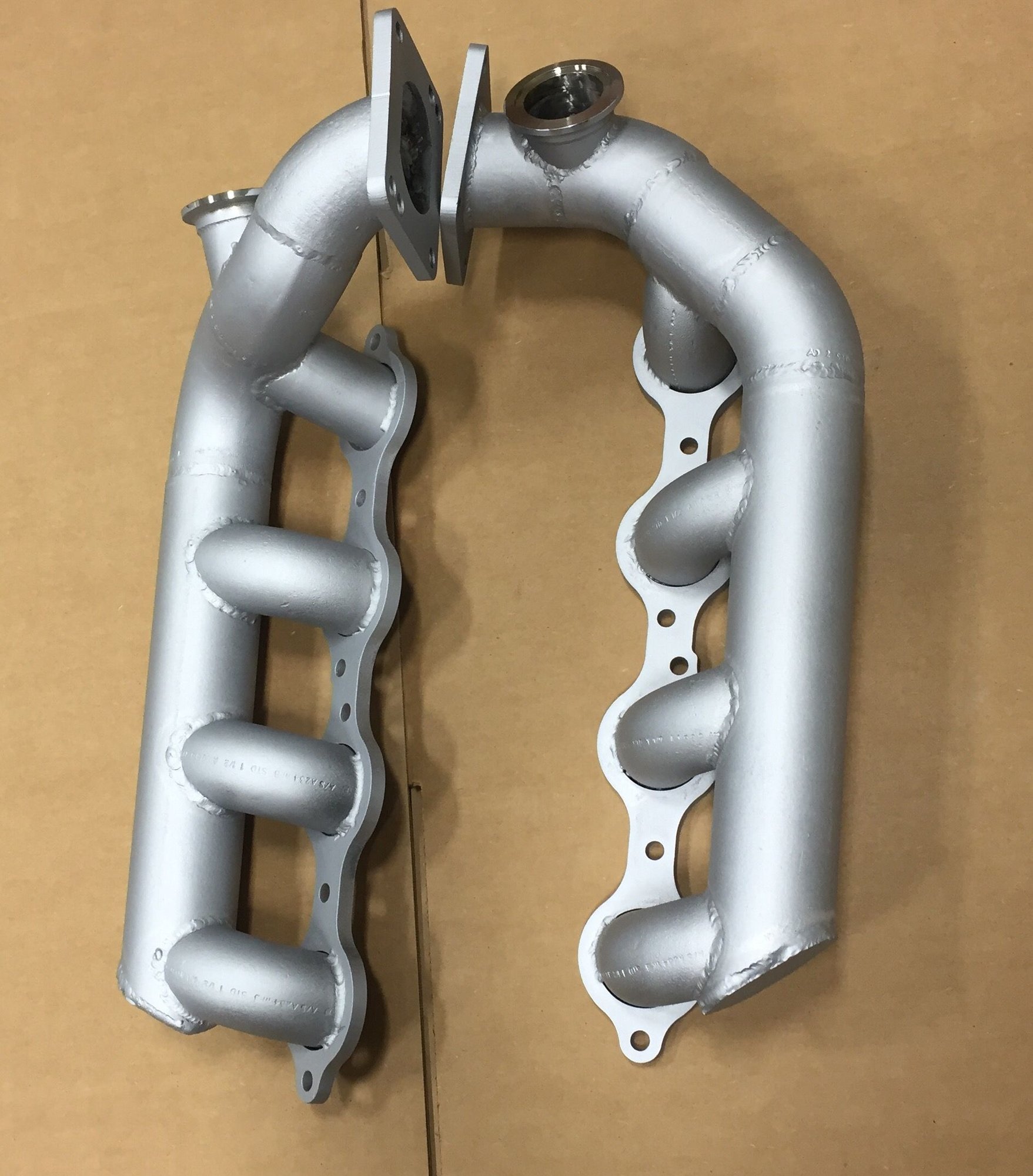

While we are on the topic, what factory manifolds work best for that? Anyone have input?
We can build a set up using stock manifolds.
But jacks up plug wire coil routing.
Forces some weird angles. Just not a fan.
For now We build the manifolds for our twin kits.
The pics shows 46mm vband gate flanges. Normally we use the 2bolt 39mm gates.

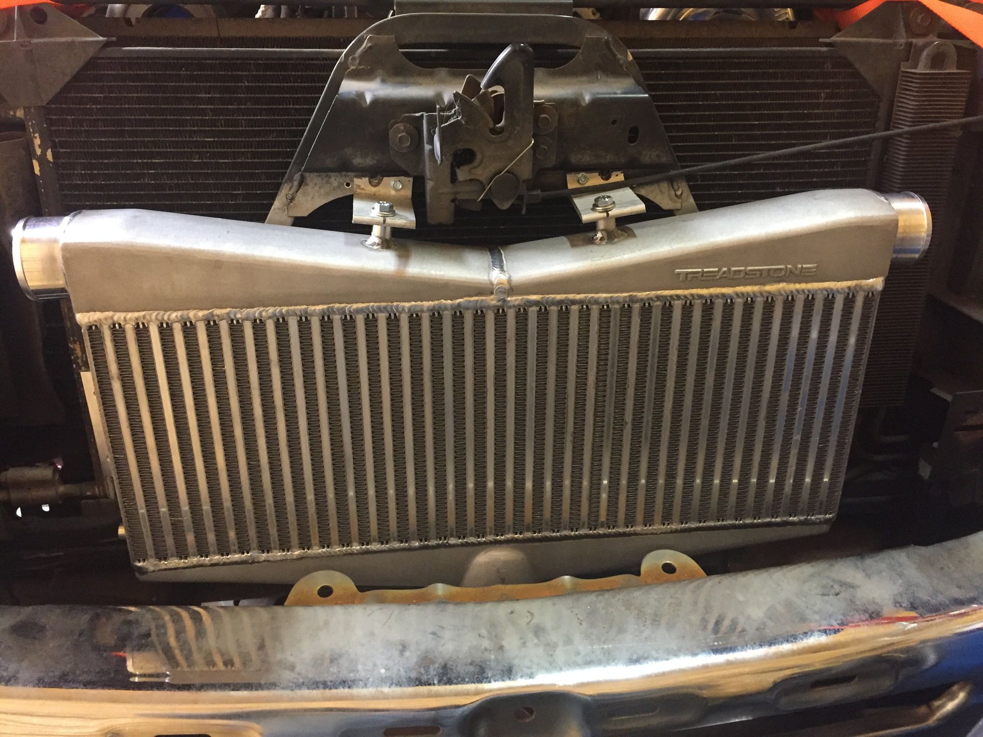

Rick, do you have any more pics of how stuff is setup on the twins?
Anything particular?

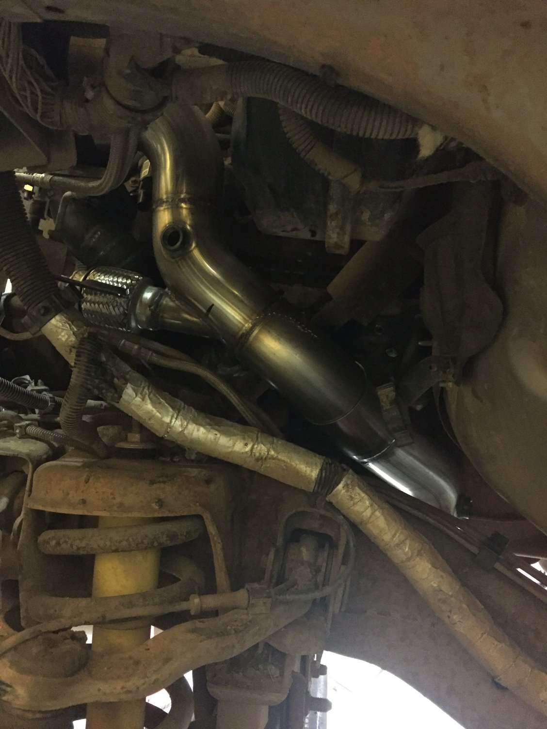

Drivers side down pipe, intercooler pipe routing.

This may sound like a silly question... but would there be any benefit to a stepped log in a twin set up?
Seems it would make sense to me... It may also make more room for the downpipe on the driver side.
All I could find at this time.
Not sure the juice would be worth the squeeze.
Our twin manifolds already use smaller log diameter then our singles.
