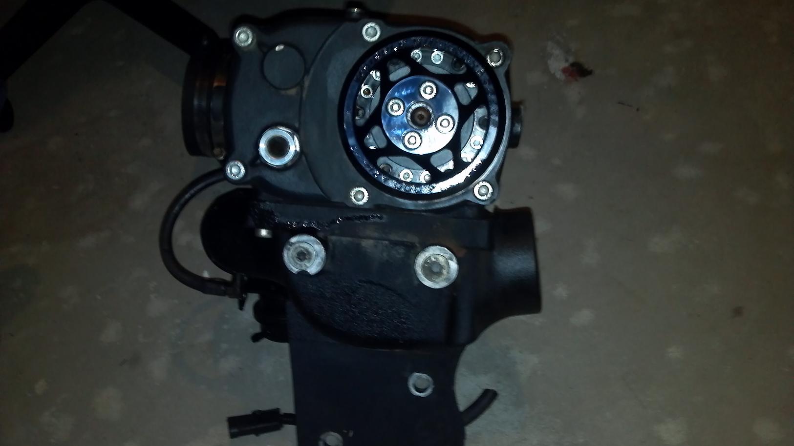

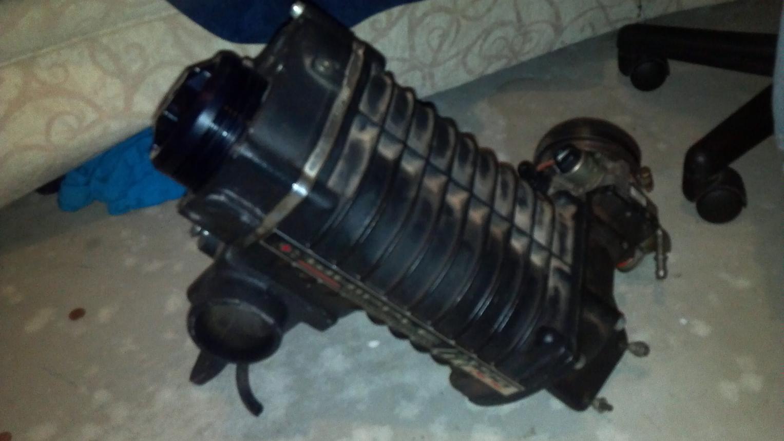

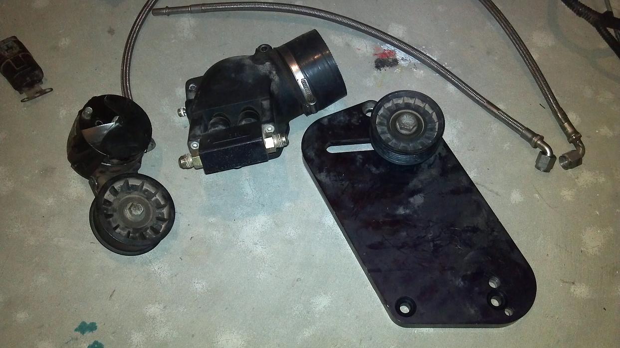

I bought a 2300ax whipple supercharger for my 2003 GMC 2500hd with the 6.0. The supercharger i bought came off an 03 avalanche with the 5.3. Is there anything from the 5.3 that wont work on the 6.0? He claims on his 5.3 that was a cable operated throttle body... mines electrical. Will that work? Here are some pics of it so if u notice anything let me know! Also what size belt do i need?

I am in the exact same position as you. I think there is a 90 degree aluminum tube where the throttle body connects that you will need. (and so do I)

Since you have a 3/4ton you truck basically has a factory body lift so the charger will fit with your electronic throttle body it barely clears the fire wall, without the 90 degree elbow. I did the same thing on a 2003 2500hd 4x4 i drove it 2 years just like that no problems. and i have no clue about belt length but im sure whipple could tell you.

Will the electronic throttle body work? The previous owner had a cable..

Well i finally got ahold of mike at whipple. He said i will need that elbow for the throttle body so it wont hit the firewall. But they no longer make them? And he said i will also need a different pulley for the supercharger. its got 4in now.
