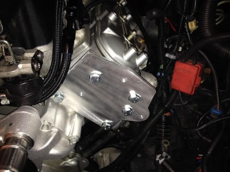

[QUOTE=Last Call;5286138]I don't think you need that bracket, you can make one for $40-50 if you have access to a sawzall, grinder, drill, and tap/die set. The only negative side to this as that the hose is in the belt path.
I've had it set up like this for about a year, no belt slip or other issues.
The other option is convert to 2010 and up Camaro accessories.
Attachment 92729
More pics are here:
I have a lmg 5.3 with 2.9 Whipple. Is there a bracket I can buy to clear the bypass actuator. I’ve been having hell eating alternators etc. used the BD10 lsx innovations spacer -3 belt line. But need another option.
