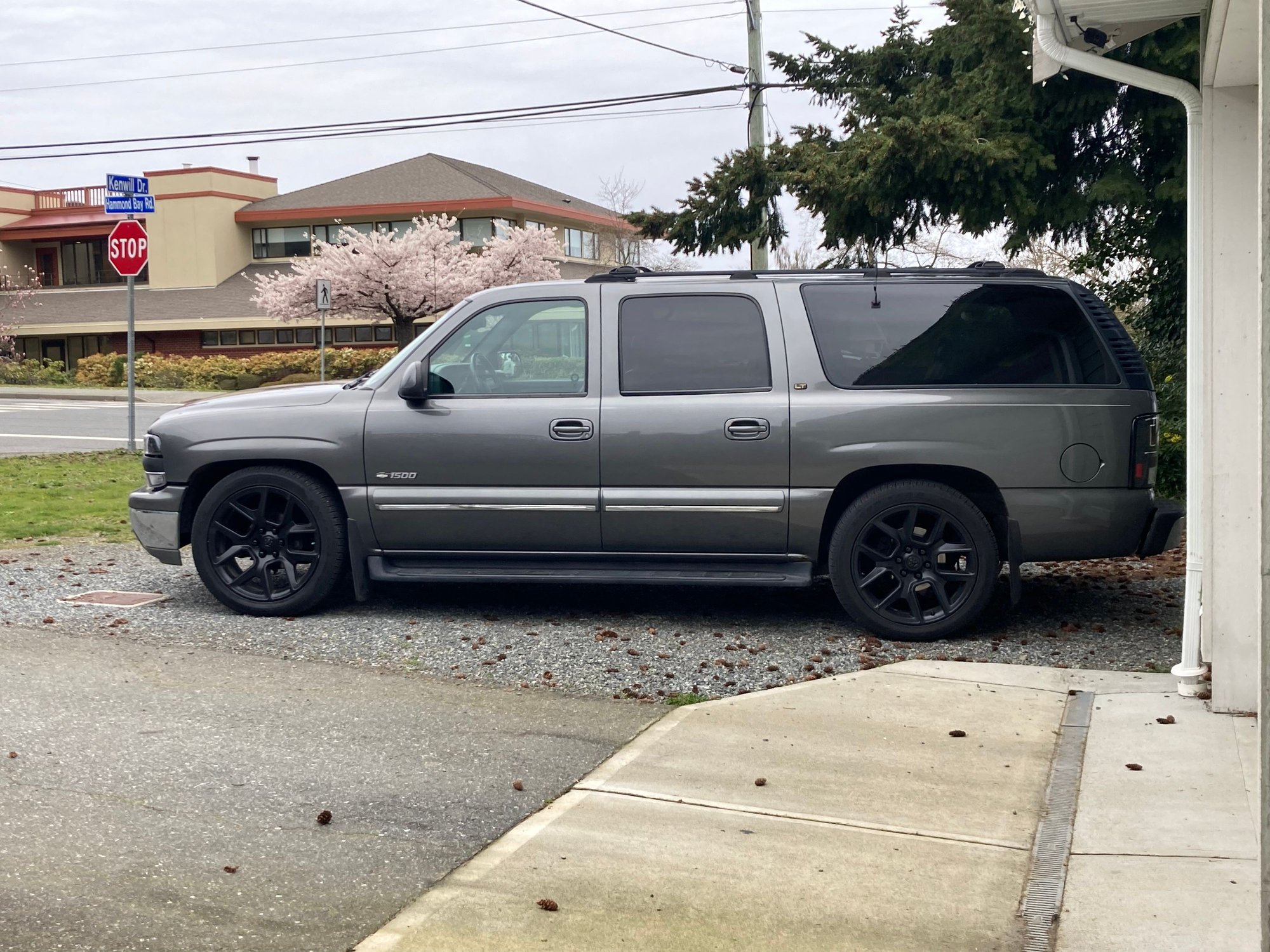

Hey guys. Totally new to performance trucks!
I have had lots of project cars over the years but have never gone the forced induction route. I’m looking for a decent but cheaper turbo kit for the Bourbon! I like doing projects that aren’t super common. Having never gone this route I’d like suggestions. Engine is 100% stock. I have just done a 2/3 drop, wheels and tires and a grille and headlights and a cat back exhaust. i don’t want to do internals yet. I am buying a 6L with a 4L80 soon and will build that. However I wanna have fun with the 5.3 for now looking for 500-600hp nothing nuts

That's a clean bourbon, are those ram wheels?
I'm all about saving money but I also don't like headaches, Trick would be my choice he's been doing it for awhile and has killer customer service.

Default Ram wheels
R.I.P. KB
Thanks it was a one owner before me with 155km on it (Canada) and yes I was a service manager with Dodge for 10 years so I have hook ups with the dealer. 2021 Ram 1500 wheels. Fit perfect
