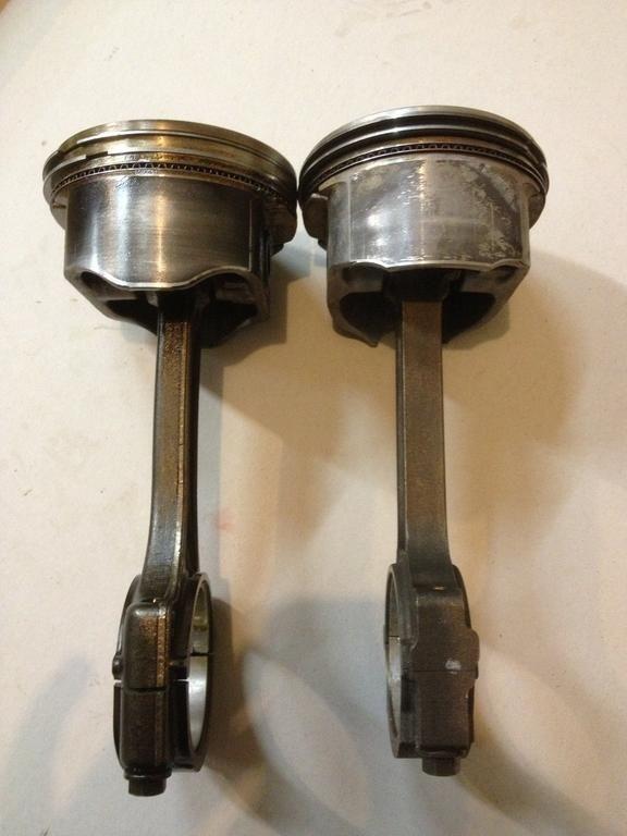

Originally Posted by SuburbanDon
is that just a 5.3 thing or because of the weight?
There is a substantial difference between gen 3 and gen 4 rods.
Gen 3 is 1999-2004
Gen 4 is is 2004.5-Current.
So pretty much you could get the truck going with a turbo on lowerish boost (8-10psi) while you get your new engine setup ready.. Or just gather parts and swap in the 6.0 and then bolt on the turbo stuff.. Sell the 5.3/4l60 and get a good bit of money back out of the deal.
Gen 3 is 1999-2004
