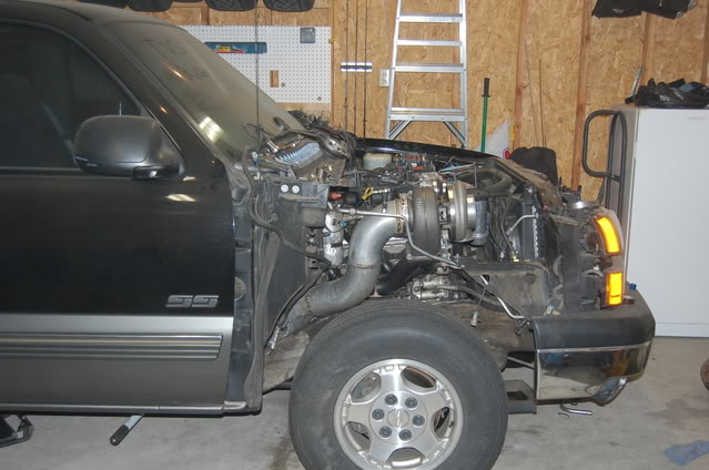

4" all the way. downpipe to a 4" cutout to a 4" flopro muffler

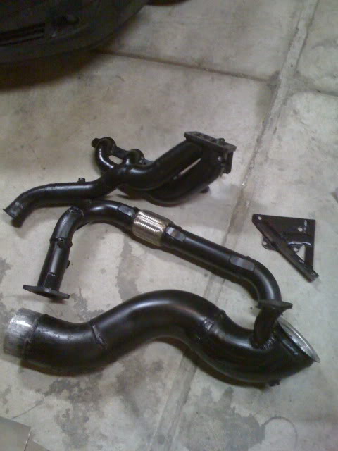

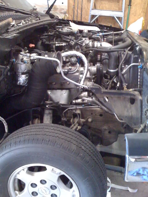

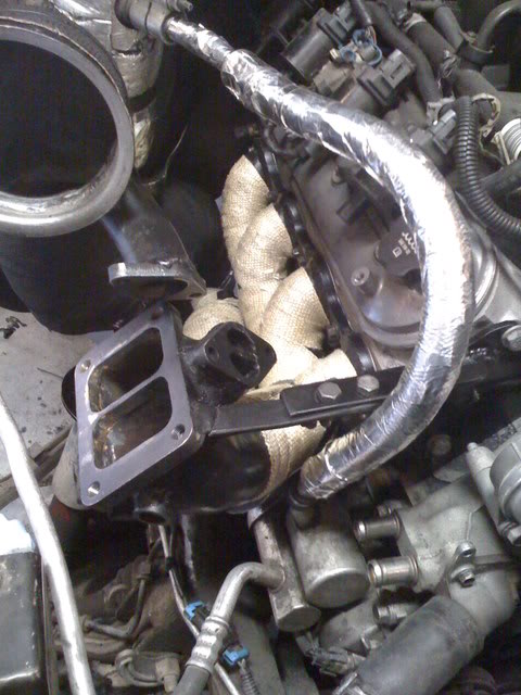

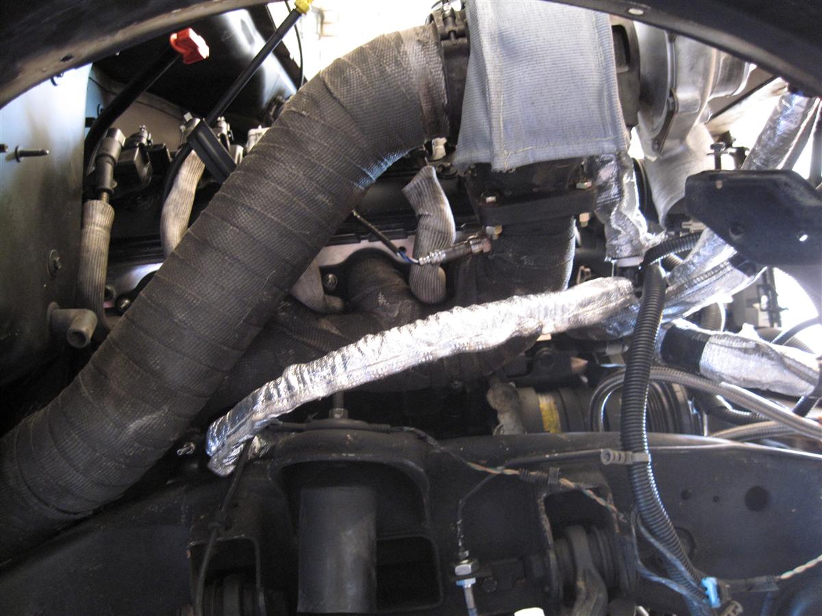

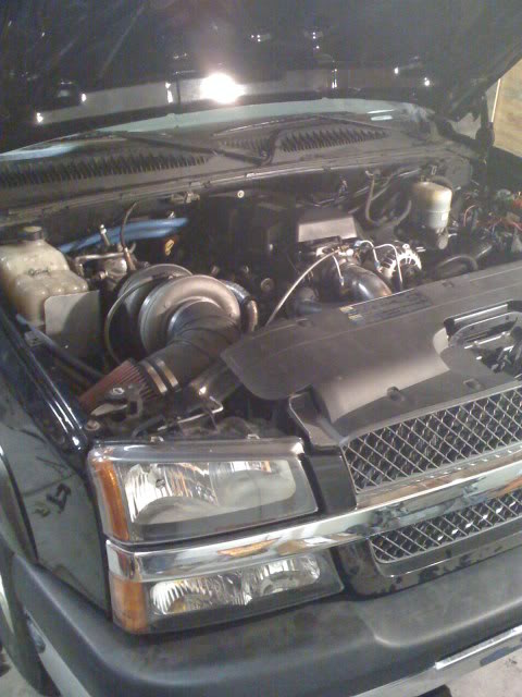

My old Little guy......
Small 5 inch down pipe, with a 3 inch cutout under passenger, 4 inch dodge exhaust.
