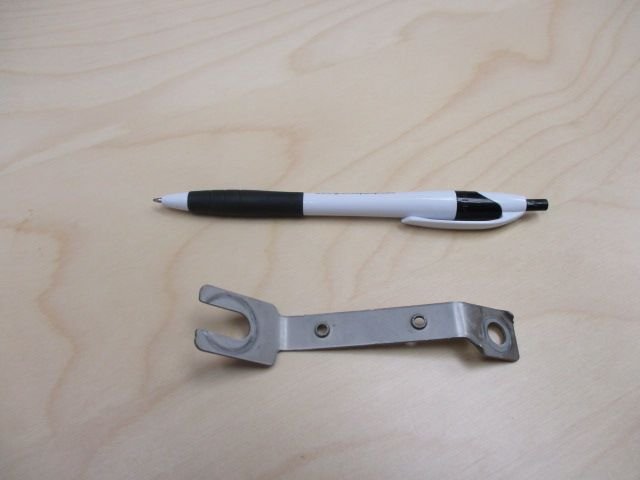

forgot to post this when I pulled the engine. I kept track of just about everything but found this under the truck after removing the engine. Not sure if it goes on the bellhousing or engine. Anyone recognize it?
