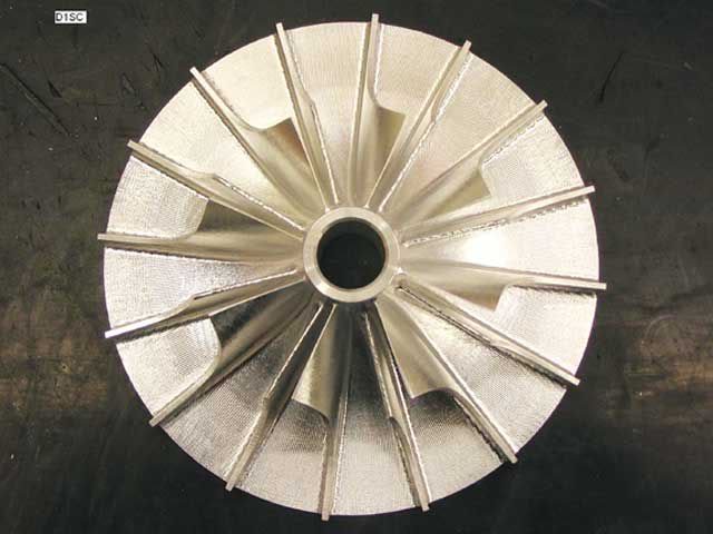

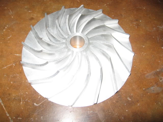

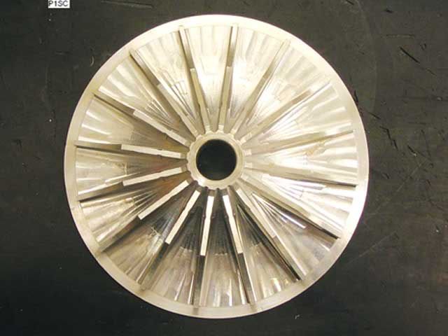

Upgrading from your P-1SC impeller to the Superchargerrebuilds P-1 stage 2 impeller isn't going to flow the same. SR's impeller appears to be an upgrade from the P-1SC impeller but doesn't have the curved blades (turbo style) common on all the high HP/flow Prochargers. It's too bad they don't produce a boost map for these Centri's so you could compare them head-to-head.
P-1SC

SCrebuild's P1 Stage ll
An actual D-1SC

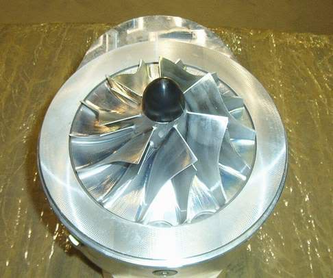

An F-1A
Just like on a turbo, the compound curves in the blades are the key to the flow. I've seen some Garrett turbos with upgrades impellers that have just a slight increase in the curve have a dramatic increase in the rate of flow.

Maybe I missed something Rick, but reread what you wrote. You say the SRB wheel DOESN"T have curved blades, the pic shows that it does, unless your talking about the blades that are laid over at the top.. I can just run a D1 wheel in the P1??
Sorry for not being more clear. The P-1SC and the SRB impellers blades are all perpendicular to the base. The D-1SC, all other high-flow Procharger impellers and generally all turbo impellers start perpendicular to the base and then curve to create a scoop (like a pinwheel) to trap the air and force it into the vane.
I think the SCR P1-Stage ll would trap more air and outfolw the P-1sc impeller but I'm not convinced it would flow anywhere near the flow of a turbo style impeller like the D-1SC.

I talked to SRB, he def said it is a upgraded wheel for the p1(345$), that it will be more eff down low and up top. I agree that it will not be as much as the D1 wheel is, naturally the design is different.. However they do not offer a D1 wheel as of yet.. And yes I am going to vent the P1 some how. That should eliminate all the blow bye going on..
