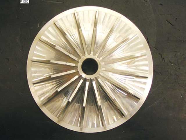

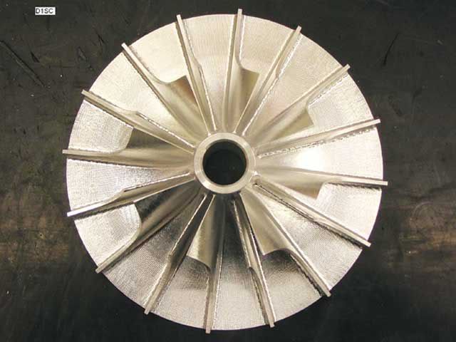

John, the top picture is of the P1's impeller, and the bottom picture is of the D1's impeller. They share the same housing and utilize the same step-up ratio (4.10:1). The only difference is the impeller. This is why the P1's have a much more linear power curve, while the D1 produces more boost at lower rpm's and can produce more boost with the same size pulley.

Thanks for posting up, yes I have checked out the diff in the impellers. I just hope a vent of some sort will eliminate the oil issue, I really like the blower, but can not justify spending what they want to give it a rebuild, not guarantee a leak free unit.. I am sure I am being alot more **** then 98% of people about it.. So like I said it will be up for sale unless i can correct the proble, a Trick kit will more then likely be on the way... BTW i wonder what kinda boost a 3.5 pulley would make on a D1

Who has had both p and d? Can you just up the boost on the p to equal out to a d? Example is 10 lbs on a p equal to let's say 5 lbs on a d?

No, boost is boost. It just takes a smaller pulley on the P1 to get the same boost as the D1. The delivery of the P1 is more linear as well.

Linear meaning straight? So 12lbs on a p1 is going to make the same hp as 12lbs with d1 but more linear. However you have to spin the p1 faster to make the same boost resulting in more heat which calculates to less efficiency? So what your really trying to say is the angle of the dangle is proportionate to the heat of the beat!

The D1 will make more boost at a lower RPM, continue to make boost all the way up the rpm band. To spin a P1 to make the boost a D1 will make at a given rpm will make more heat at the same boost level with the P1..
