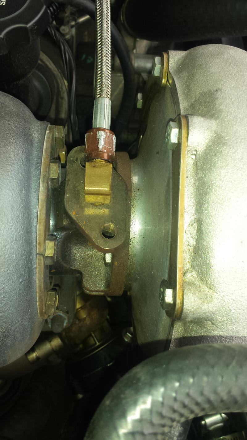

Size:  147.0 KB which boats am I taking off

Likes: 62
From: Wichita Falls Tx.
The 6 on the turbine side.
Remove the bottom ones first.
Then while removing the last two on top.
Hold the turbo and slide forward.
Nothing will fall out. You will hear the inside shield clank cause its loose. But will not fall out.
You will also need to take you oil lines off prior to removing turbo.

Sorry trying to make sure I get it right down wanna screw up the turbo. I'm removing the bolts numbers 1 correct? Name:  2015-02-15%2021.04.25.jpg

Looks correct. The 6 bolt going rearward that screw into the turbine housing.

got it im going to work on finding the leak tomorrow.
