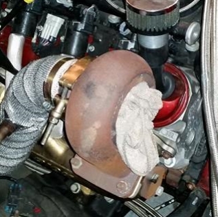

I unbolted my turbo from exhaust housing, bolted exhaust housing down real tight, then bolted my turbo back together, took 10 mins.
how hard would it be to take it apart? I've never taken a turbo apart. Defiantly don't wanna mess it up

6 bolts.
Just the your time and don't drop the turbo or side load the turbine wheel.
