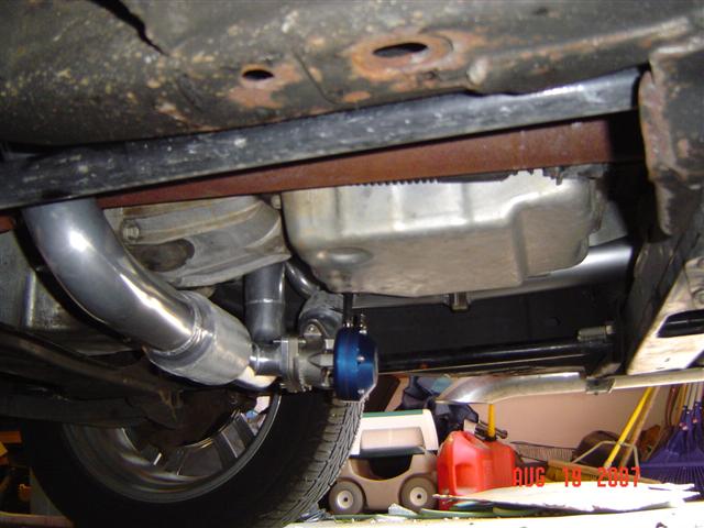

You'll want to take apart the wastegate and spin the vacuum lines to point up.Like this.
