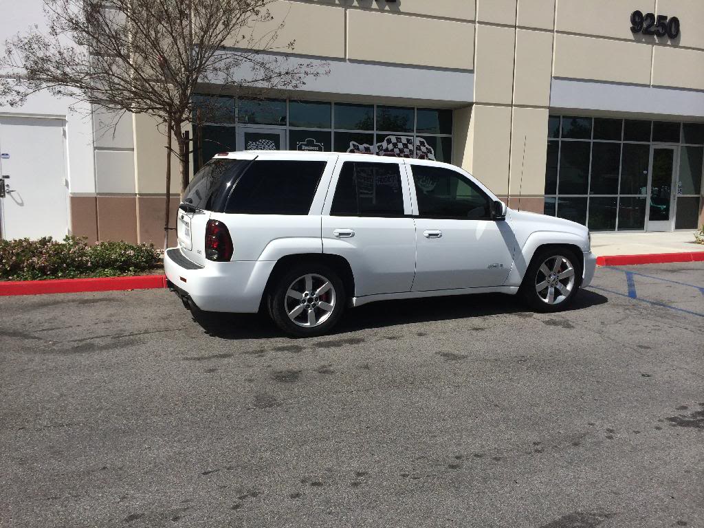

Swapped the wheels also.

295/45/20 Yokohama radial tires. Been having way too much fun trying to get traction. 60-120 comes really fast.

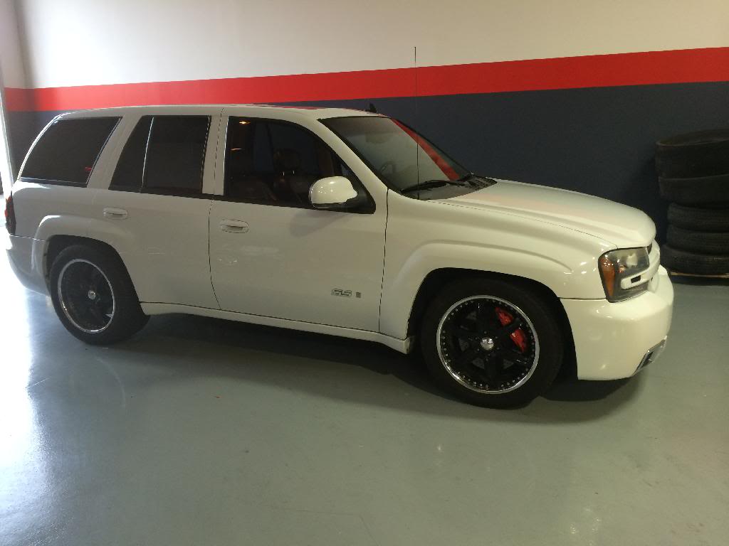

Brakes are amazing, one of the best mods I've done. Here's a pic of her with the rear 18" drag combo.
