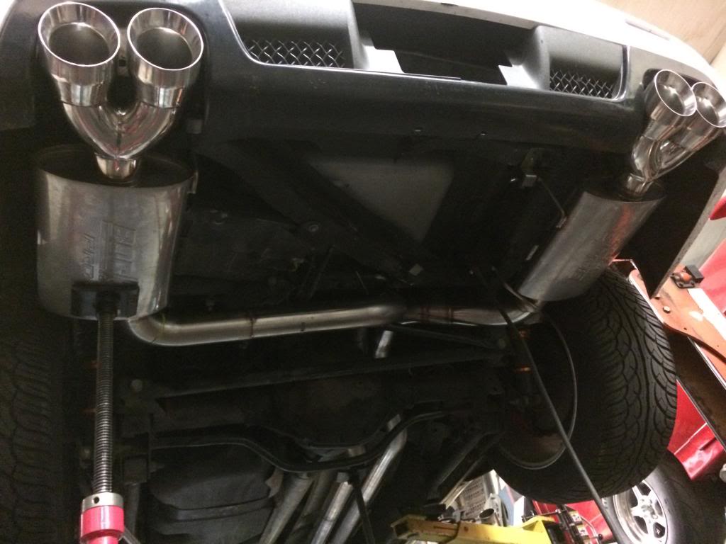

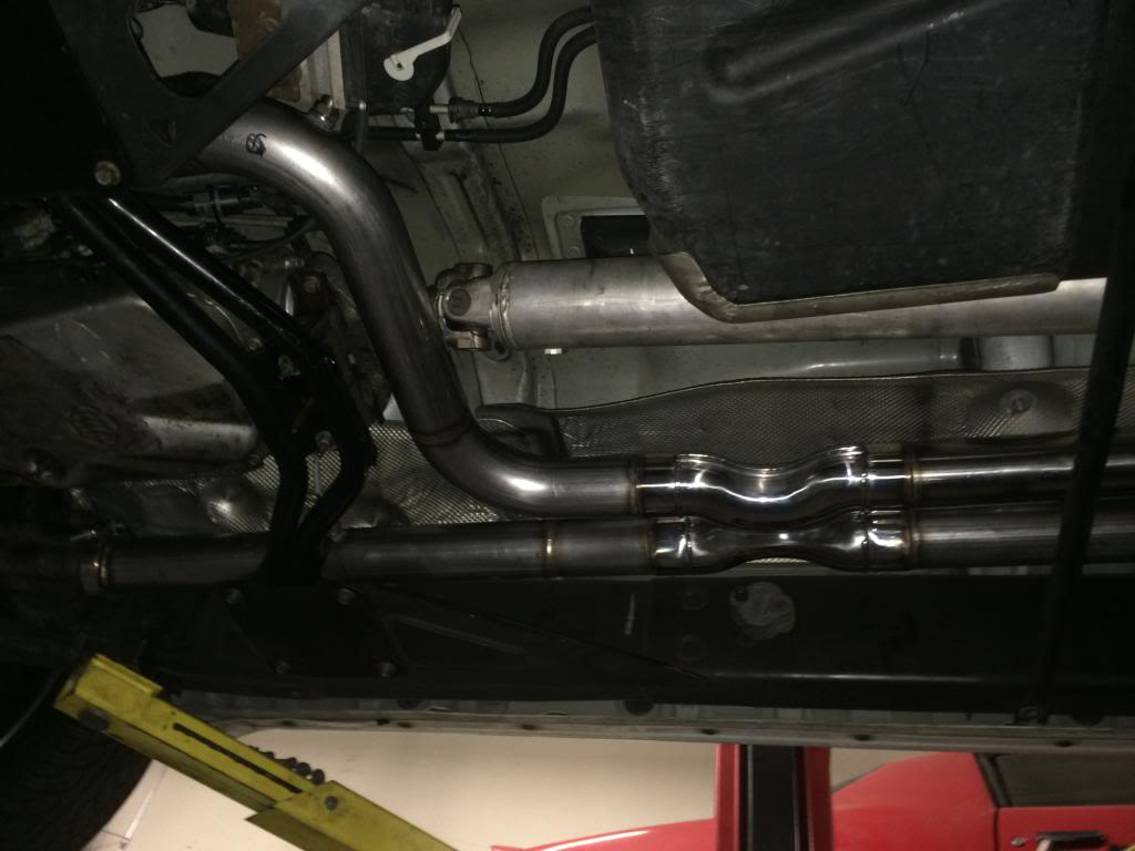

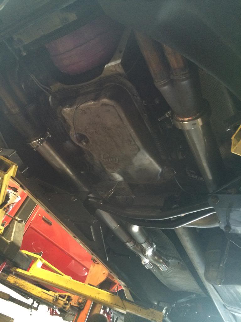

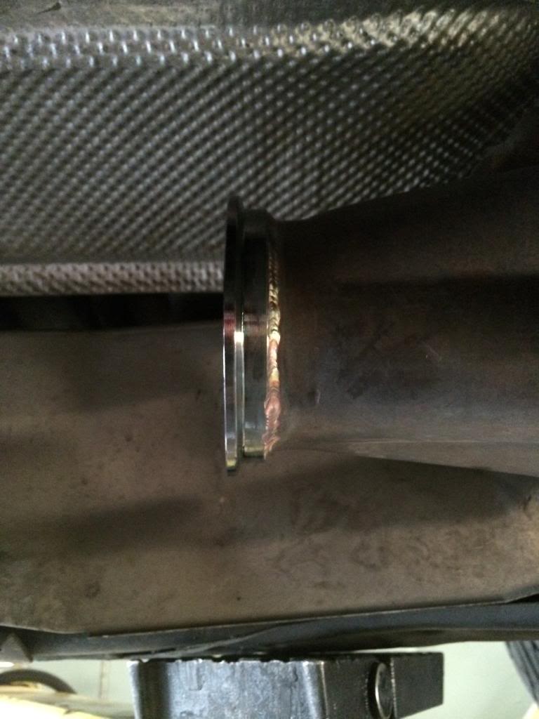

Well did a few changes. BTR2 cam, and TDs 3" all stainless. Also will be getting a complete new tune. I'll post results as soon as we tune it. Will be on the same dyno. But here are some pics of the exhaust work. Also got my hands on a jackshaft 2300 that later this year will be getting installed. That way I can have some back to back comparison on both blowers.

It's a cam my engine builder had installed 223/234 .610/.612 120+3. Speaking with the guys at BTR they said if they could slap me upside the head they would've. They actually were pushing for the stage 3. But I wanted a tamer sound.
Yea from what I was hearing the single 3" exhaust was strangling the TQ and top end. I can't wait for results.

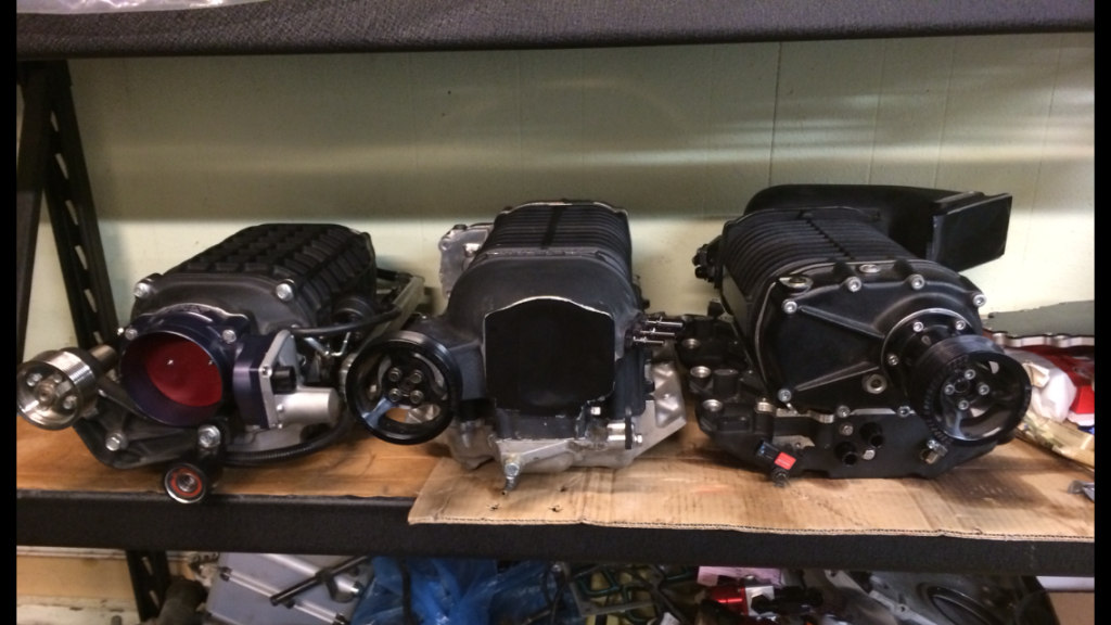

Thanks for the offer but the only 2.3 I'm looking at testing out on the TBSS is the jackshaft style Maggie . Here's the new collection collecting dust in the garage.
