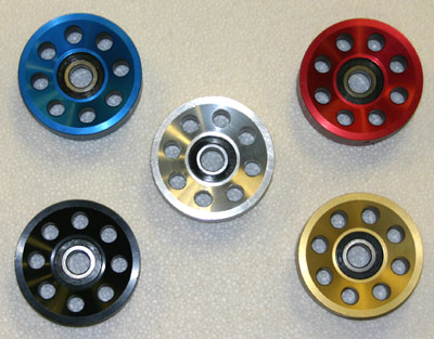

Pick up a couple of these, then get a manually adjustable tensioner and add a Gatorback belt. Problems solved... Also, I don't think belt being too tight is a problem for long because they will stretch.
Pulleys from Thumpracing dot com
cool colors too...
PM-2076 76mm Billet Aluminum 8 Rib Pulley
Heavy Duty CNC Machined Aluminum Pulley
Can be used in either the tensioner or idler position.
8 Rib pulleys will work on both 6 and 8 rib setups.
Available in silver, anodize black, gold, red, blue, clear, see color scheme here
MONTHLY SPECIAL - NO EXTRA CHARGE FOR COLOR - SAVE $15.00
$35.00 Choose color: Qty:
PM-2090 90mm Billet Aluminum 8 Rib Pulley
Available in silver, anodize black, gold, red, blue, clear see color scheme here
$45.00 Choose color: Qty:
PM-20100 100 mm Billet Aluminum 8 Rib Pulley
$58.00 Available in Silver Only Qty:
Attached Thumbnails Tearing belts -help!!!-pm-2076.jpg   Tearing belts -help!!!-pm-2090.jpg   Tearing belts -help!!!-pm-20100.jpg   Tearing belts -help!!!-pulleys-colors.jpg
