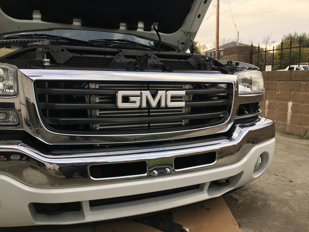

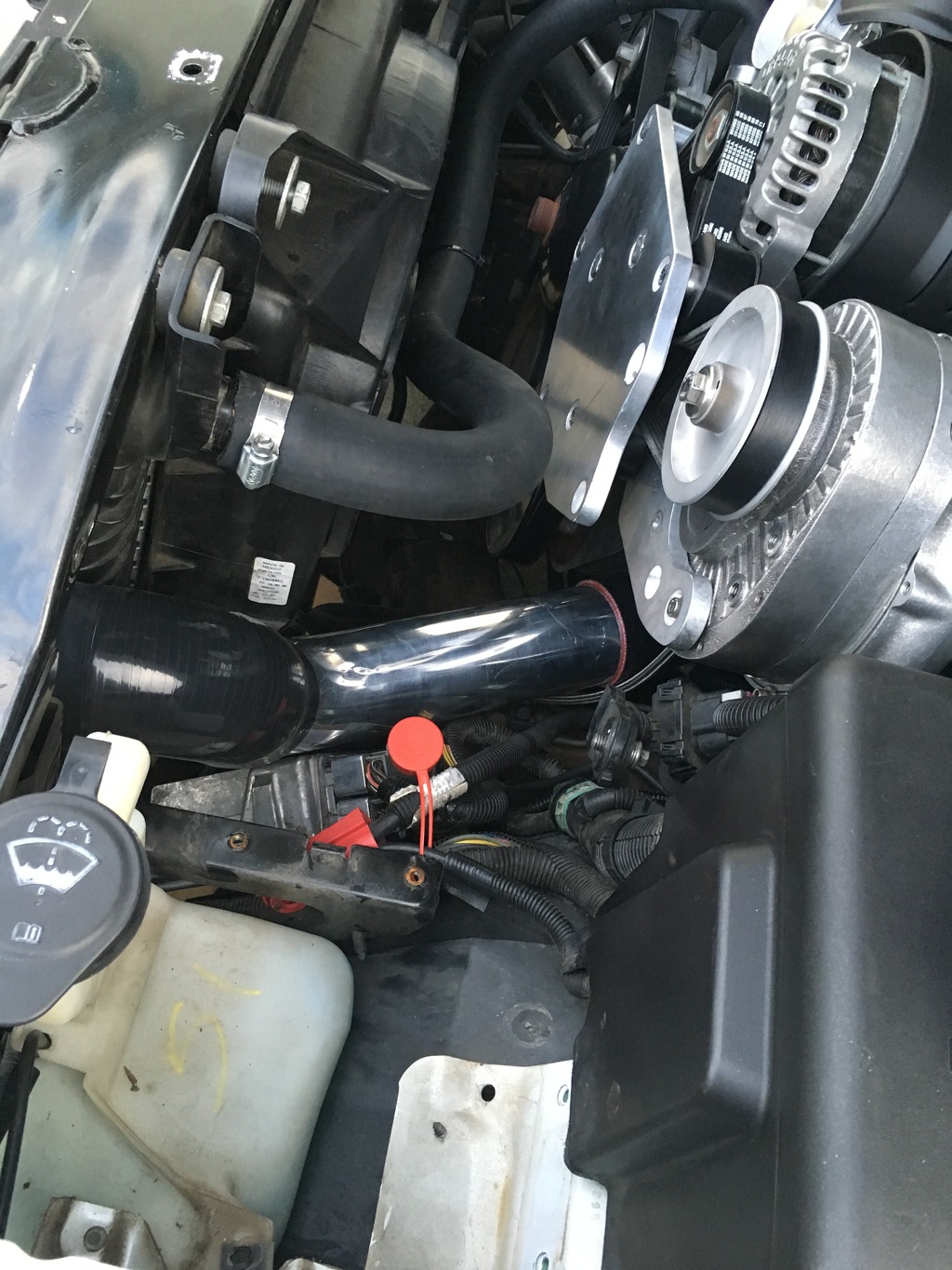

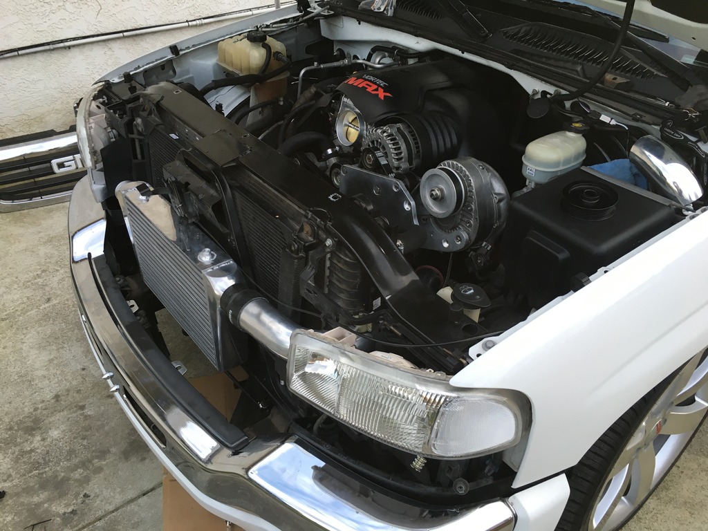

Got it figured out, the pass side will be easy, driver side was a bit of a pain though. Had to move the ecu, so have to find a place/how to remount it
