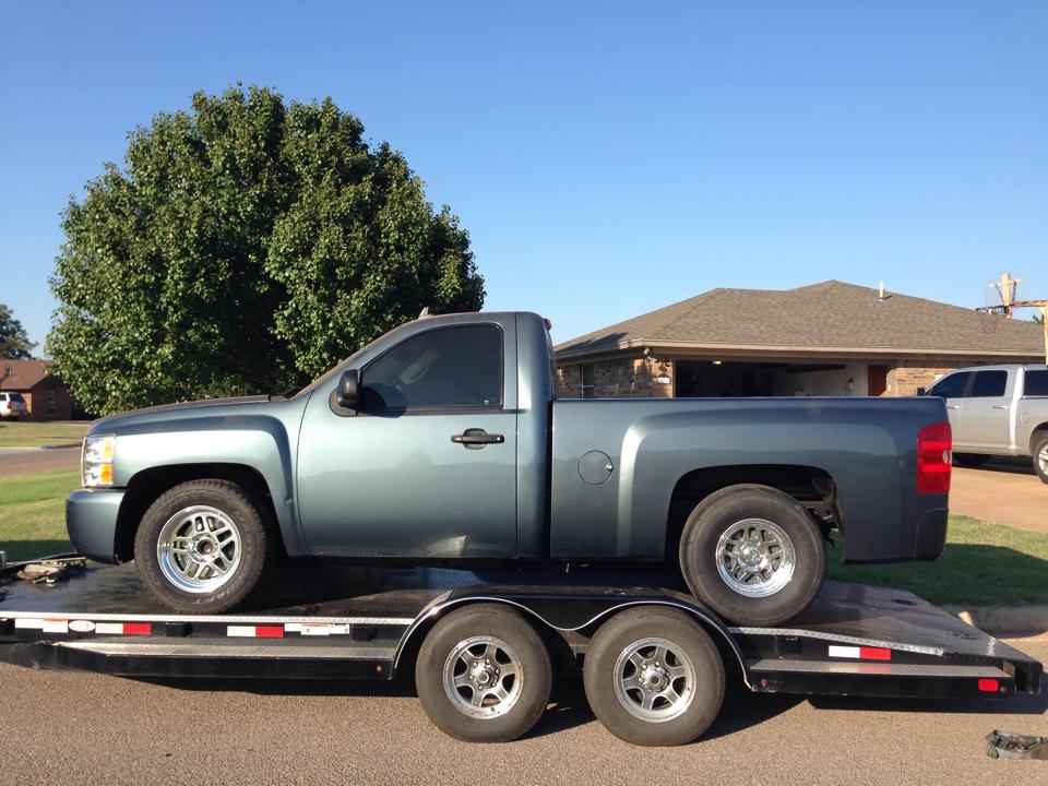

Here she is about to head to the tranny shop for the 4L80e swap. First time she's seen the outside of the garage in 8 months.
