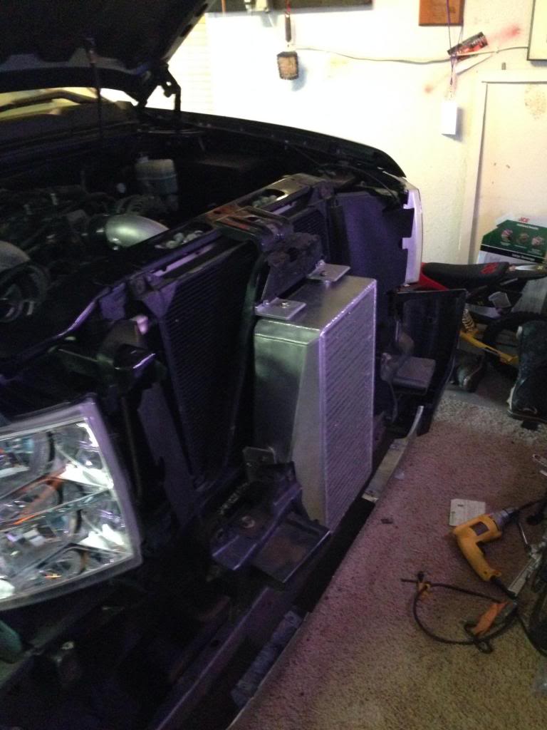

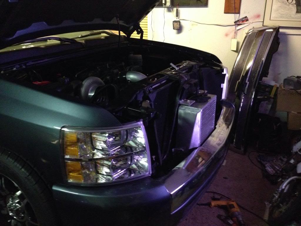

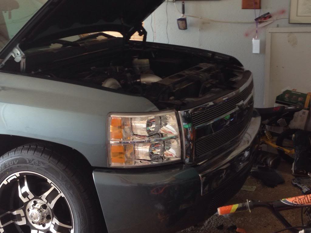

Well it's been a while since I updated this. Slow going on this install, just doing a little here and there as time permits. Here's a few pics on the IC install. Got a bit further along than this but I haven't taken pics yet.
Clearancing everything for that cooler was a bit of a chore, but not as bad as I thought it was going to be. Even called Rick to see if I could swap to the smaller 4.5" thick core... But in the end I manned up and put the big one in lol. With everything trimmed, it fits well and nothing rubs. Yeah the garage is a little dirty and cramped, but the ol lady wasn't about to keep her car outside so I could install what I spent vacation money on... LoL. She's still a little mad about that.
