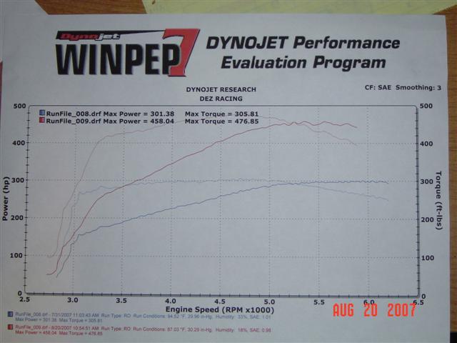

Weel,my jobs at work got screwed up so I had time to dyno.This is at 7lbs of boost,11.5-1 A/F, 17 degree's of timing.All fully street tuned with this 1 dyno pull in 3rd.

Those are some pretty good numbers! I still haven't dynoed mine but hopefully its somewhere in that neighborhood.

Not glad your other jobs got screwed, but SWEET you got to dyno the truck. Nice numbers I think, for no meth, very safe street tune.
Now that tranny probably is not going to like you....

For a 500hp rated turbo this will go past that easilly enough.150hp from only 7lbs is great.Just think what 12lbs is going to do
