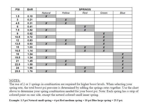

Guys I have been puttsing around on a 3lb spring, I'm headed to dyno this Thursday. I have an Innovate SCG-1 controller. I want to make 10-12psi, but I don't want to hassle the tuner with a spring change on the dyno. I was thinking of combining the 'natural' and the 'green' springs, the chart says 10.5psi, and then using the boost controller above that. Does that sound reasonable?

Why when the solenoid can be used to raise past the mechanical spring pressure?

and use your strong hand! that spring pressure is no joke..
I used a 7lb spring spring in mine and used the boost controller to go up to 12 psi
