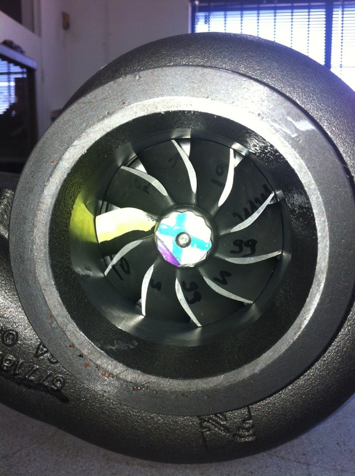

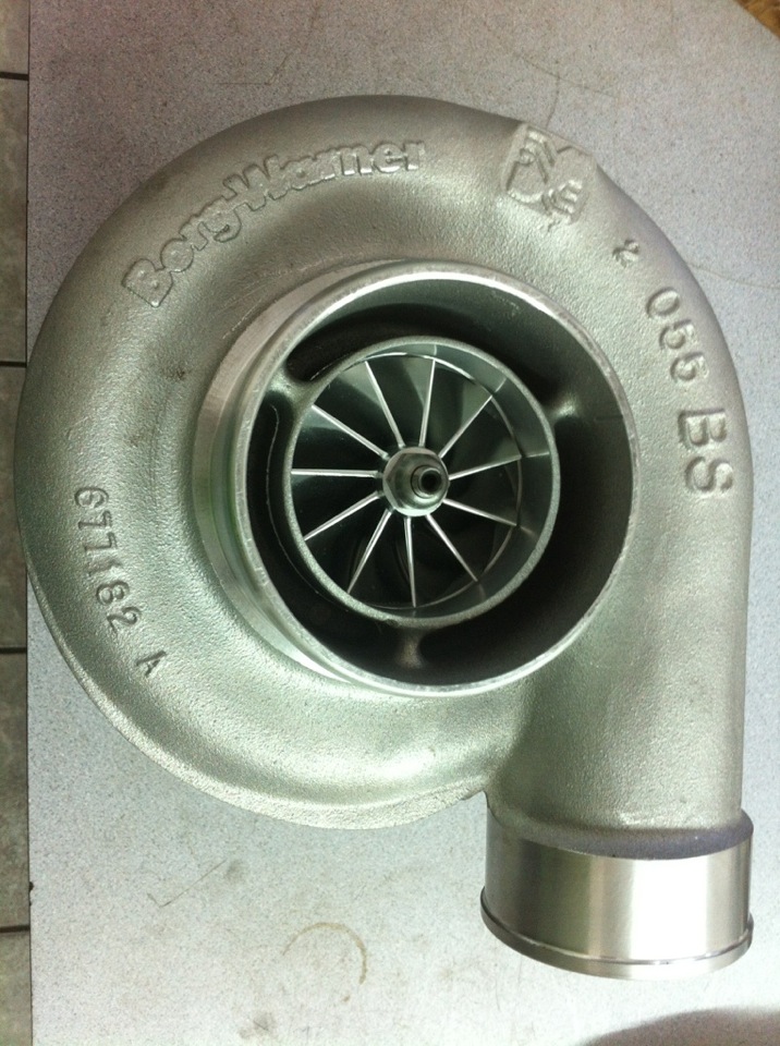

I'll even post up the pics of it because it's a family member.
Boostlab call it's their BL366 HF

I don't think it would make a 1000HP on a big v8, I think a 4.8L/5.3L would be the cutoff for flow with the 73mm turbine wheel and strong street manners. However, it should kick some serious butt for it's purpose. For 950 shipped to your door, it would put a hurting on a magnum or turbnetics TC series any day of the week.
Hey if you want me crank 20psi thru her on the dyno and then send it back to you, I have zero problems with doing that.
