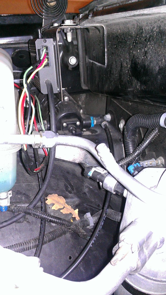

Just for something to think about, when I ran meth, I used an old coolant reservoir to hold my meth. It looks factory, holds plenty, is clear so you can see the level, and most importantly most reservoir tanks come with a low coolant switch in them. I never completed it as I swapped projects, but EFI Live offers a valet option (I would assume HPT also offers this) that can disable the engine above a desired RPM when triggered(I am now using this option as a 2-Step). I figured this would be a good failsafe way to kill the power if the reservoir happens to run low. Here are a couple old pics I took.
