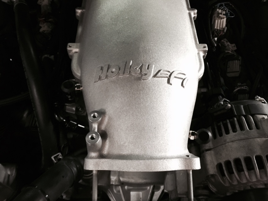

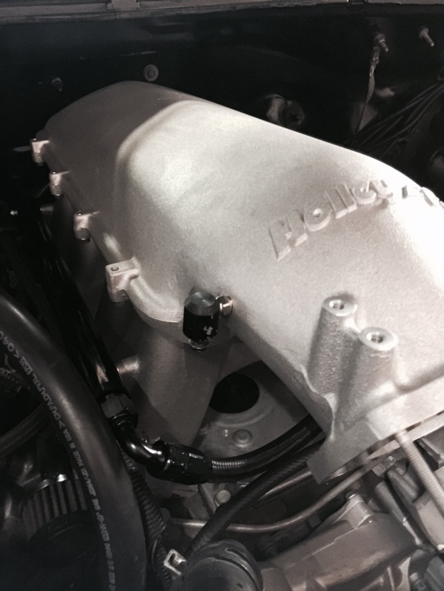

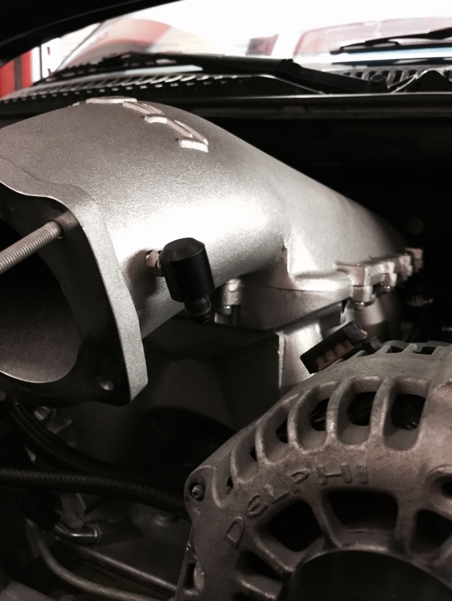

This one is for the haterz.... Post throttle body, opposite sides and staggered.

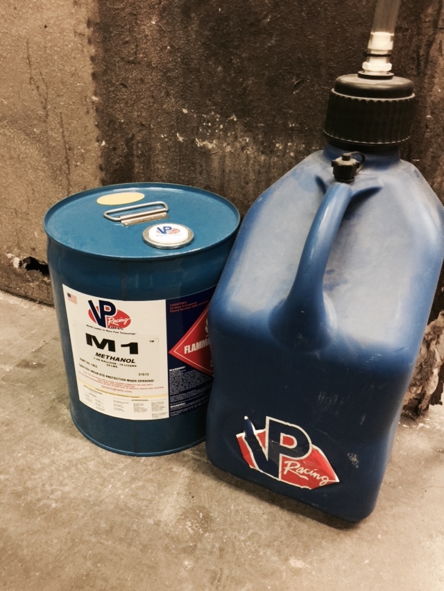

And I drove clear out in the boonies to get the meth today. Half a day wasted
