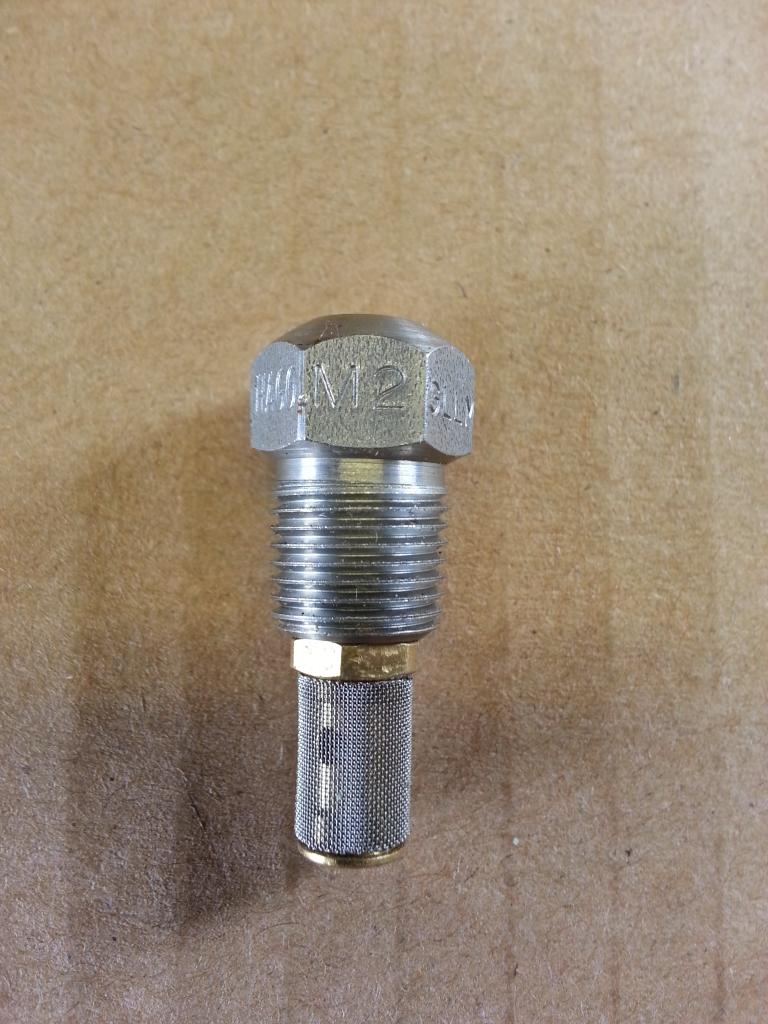

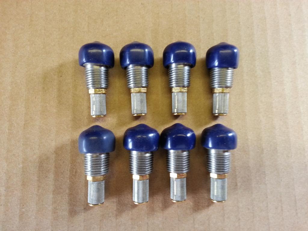

I do have 8 small nozzles that are brand new and I would make a good deal. I was going to post up some stuff for sale soon, and that was part of it. I also have a meth kit I will be selling.
