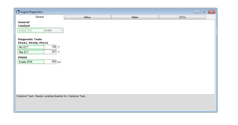

Basically it feels the maf/map/tps corillation is wrong and outside of normal operating ranges. Which they are. I have a screen shot that I took a while back while doing my Colorado that I will dig for. Yours is probably going to be the same type of thing

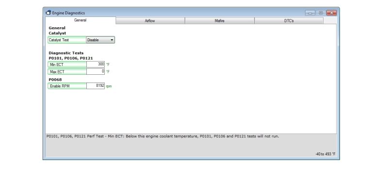

So this is what killed the reduced power problem with me
Before:
After:

Check for vacuum leaks also. Anytime the map sees something the mad doesn't the computer sees a problem and will go to rep mode. So you either find the problem or change the portion in the tune that deals with it.
Also I took my tb part once to clean it. And when I put it back together it had a very very slight drag to it. Soon as I started it I got rep mode. The blade was off just a hair. After I fixed it. All was fine again.
I've also seen a big cam with low idle vacuum cause this too. That one I had to just change the tune like in the pics above.
