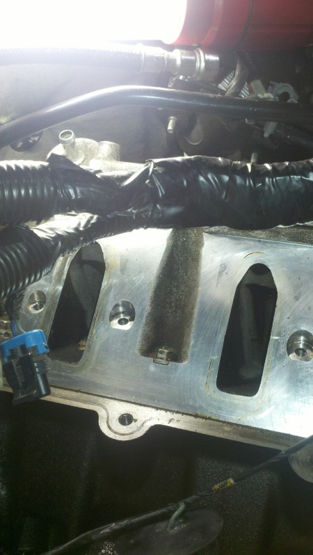

I noticed this when Radix came off to find oil leak, see Part I. BTW, here's a shot of intk. ports, oily residue. Time for a catch can!!!

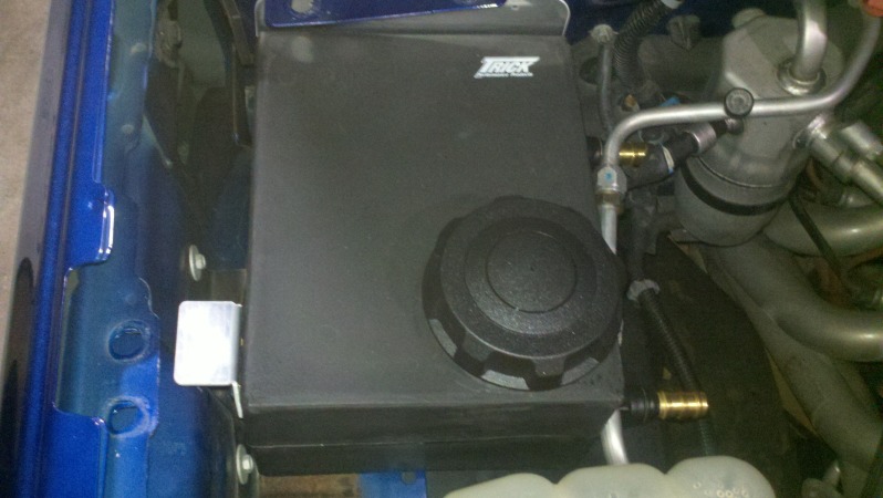

Trick Tank 1 1/2 Gal. Composite.
Fender brace needs to come out to put it in there.
-10AN - 5/8" Barb is same thing. I had powdercoated too. Original IC tank is only a QT, whole system holds a Gal. This adds 5 more QTs. So 2 1/4 Gal. If my math is right.
I would actually prefer a fitting that didn't run so close to A/C & was angled away. I had some spare to go this. And the line farther away from firewall, I just swung the hose that went to side of orig. 1 QT. IC reservoir around to pass. side. No addtional length or cuttin needed.
