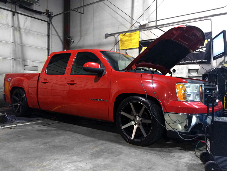

OK, I got a few images of it on the dyno.
I want to wait till ProCharger gives me the "thumbs" up to post the results.
However I am blown away right now with the gains.
It makes 6psi at 1,900rpm and full 8psi by 2,400rpm!
They program that "curve" to come in like that to be nice to the pistons.
So the boost doesn't hit to hard down low, and lug the motor.
Though I will be able to change all of that from inside the truck.
The boost "curve" as well as the overall boost level.
Being stock, I doubt I will push it much past 8psi.
The TQ gains are unreal, even at 1,900rpm.
And the pull up top is typical centrifugal awesomeness.
Its a really cool concept for sure. It will be interesting to see how well it stands up to being pushed to higher RPM and boost. I would imagine the internal transmission has a breaking point...
I know that they have been testing it at MUCH MUCH higher HP levels then my 5.3L will ever see.
I have seen cars already making 650-700+ rwhp on other forums with the i-1. Camaros and Mustangs mostly. (Cam and E85)
The i-1 has electronic "safety" features built into it to keep it safe.
Pretty neat stuff actually, but that could be a whole post in itself.
But in a nutshell, its electronically limited to 80,000rpm ProCharger stated.
So even if a person keeps trying to turn it up past that, it will just stop at that RPM.
I have no idea what kinda HP that equates to, but the idea of "overspinning it" doesn't exist.
Ya, what he said.
Soon as I can post the dynos I will, however here is a teaser.

Does this use a centrifugal clutch/pulley size like snow mobiles use?
Old Mar 4, 2015 | 05:41 PM
E.A.'s Avatar
Joined: Oct 2005
Posts: 123
From: Boostville
Originally Posted by Choda
Nice looking truck
CVT transmission and belt.
There is some info in this video.
ProCharger is going to do the HD trucks as well, photo in their blog.
ProCharger Supercharger Blog » ProCharger i-1 Systems, NOW for 2007-2013 GM Truck/SUV?s and 6.2L F-150!
