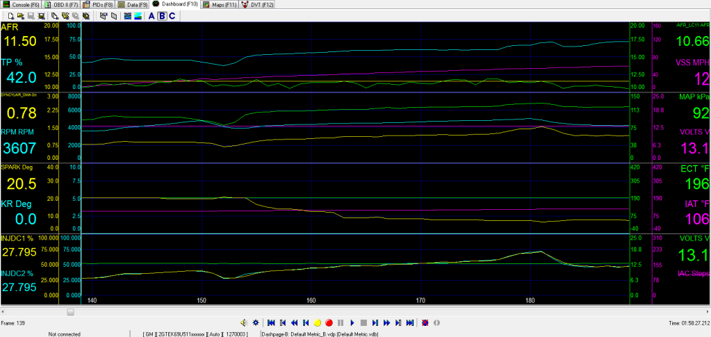

mine doesn't start building boost until about 3600rpm. And I have a D1 with a 4" pulley. are you putting it in Neutral and revving it?

Hmm..thought it started building boost lower than that...It was while driving and was staying very light on the throttle though. Ordered a normal proflo anyway to replace the one I have.

this is one of my logs. on the far left of the graph you can see the rpms are about 3600. if you look to the right side the KPA is 92. Atmosphere is about 90 here.
