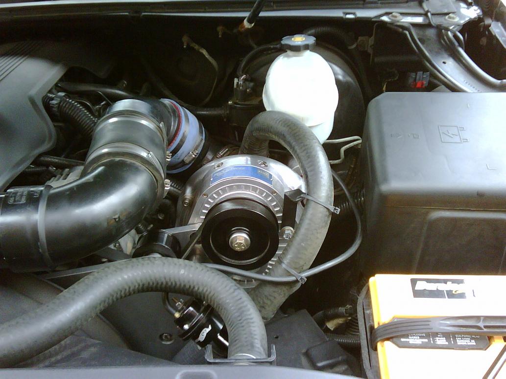

This is my PC cold air set up works good ...i got most of it when i bought the kit i did make some brackets to mount in fender k#N had a bear getting away from master cylinder ...

haha forgot to take off that strap i put a brackett in its place the brackett for the positive battery cable worked perfect

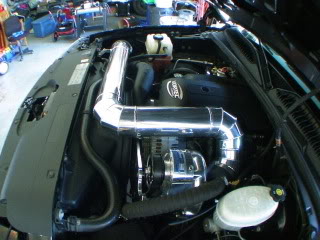

heres a quik lil video of mine...
and a pic...
and a pic...
FRIIGGENN SWEET I like yours better thanks for the pics NICE...did you weld all that yourself
no i cut it all and taped into position and had a friend weld it up, then i hand polished it , thanks.
do you got a 8 rib setup? so you said you got the filter inside the fender? if so post some pics of that would love to see it.... very creative by the way!!

no i got the standard but with the 3.70 pulley ...hey why i got you where did you tap for youre boost gauge...if you run one
