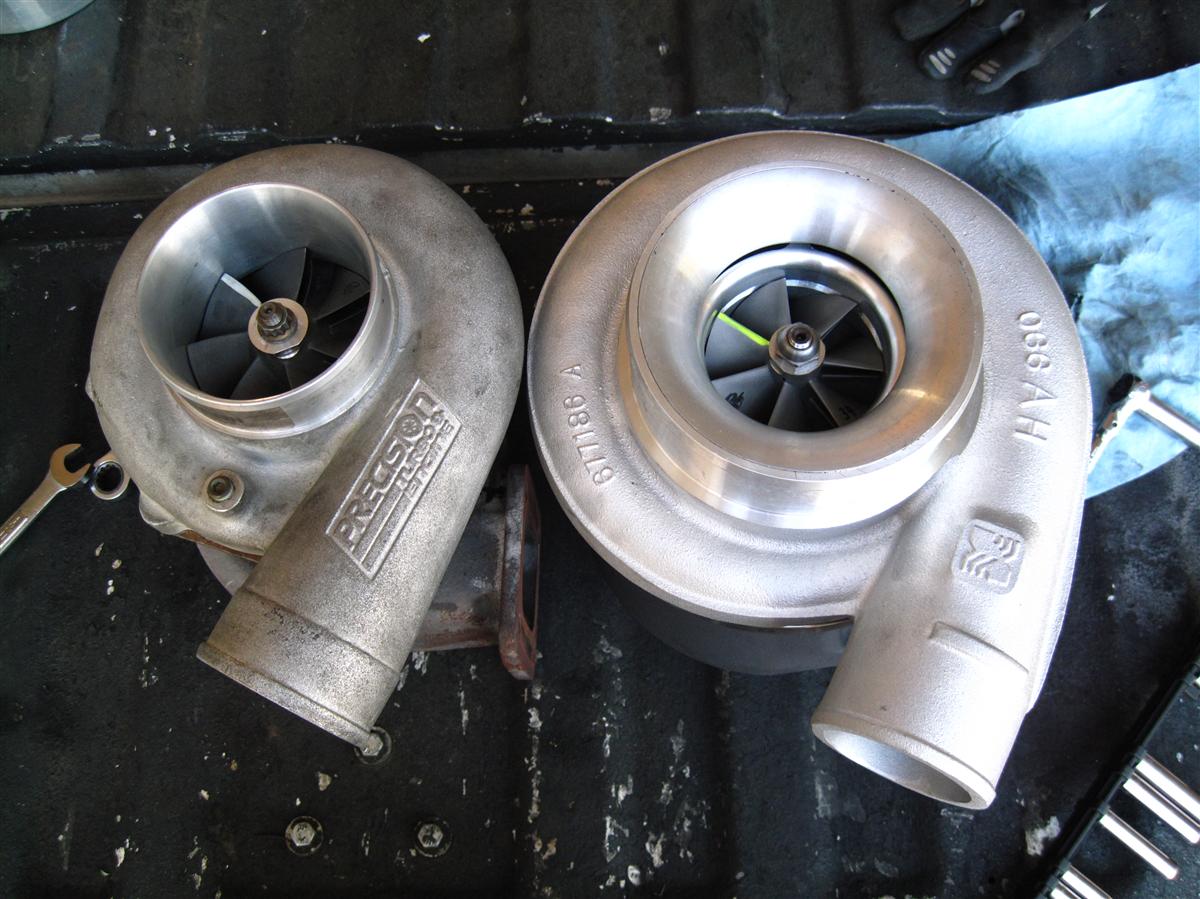

Heres my old PT88 sitting next to a s400-76mm with the "race" cover
The PT88 is 20 year old technology, I did not driving it at all. The Borgs are much easy to control. Peak power may be a little less (100hp maybe), but turbo response is much better.

Cool, nice side by side shot! The compressor side sure is bigger but that shouldn't be too much of a fitment issue. What about turbine side, any idea? It sucks that I just finished this thing a few months ago, I don't really want to go and redo a lot of it already.
Peak power... the PT88 is rated at like 1,250hp, I think the BW says about 1,150hp. I don't really know how that would effect the power I'm making now or if I would even see a difference with that beside the way it comes on.
