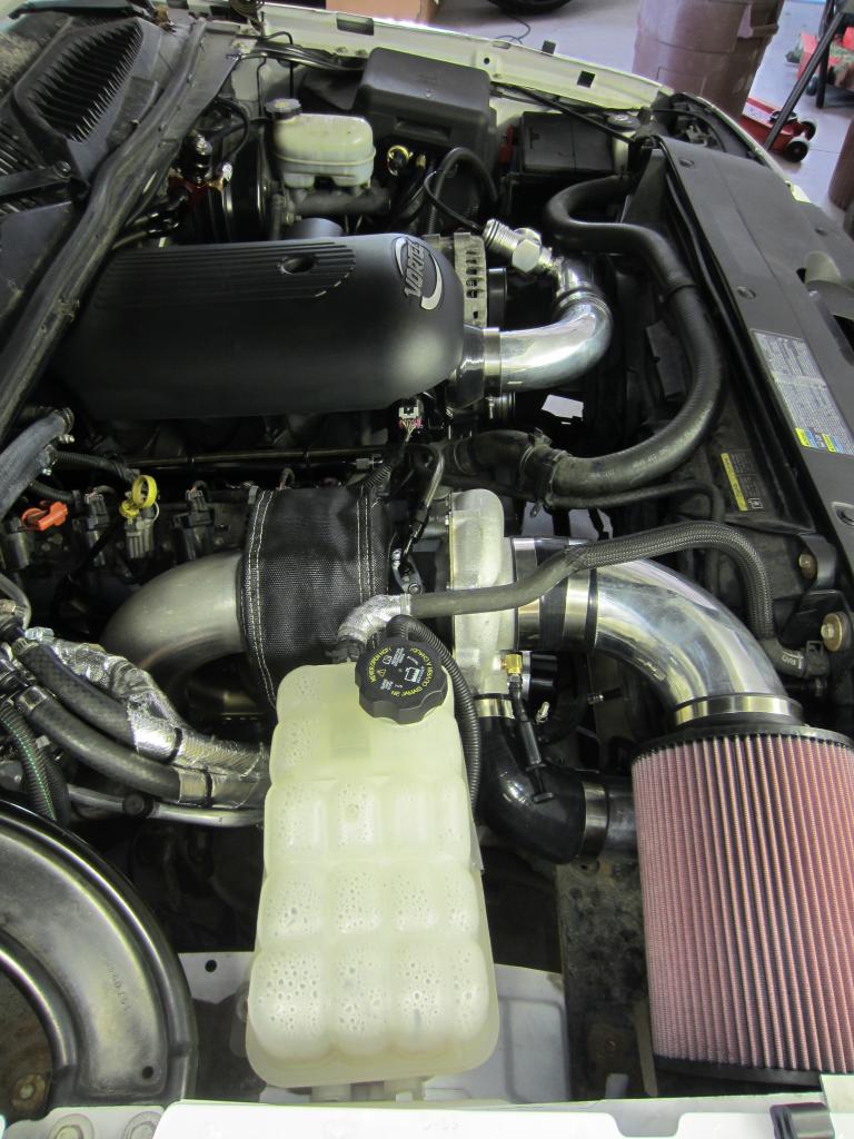

You want the biggest air filter you can get also.
Old Aug 19, 2014 | 01:08 PM
cpolaris502's Avatar
Joined: Jul 2012
Posts: 299
From: Minnesota
I have that covered.
