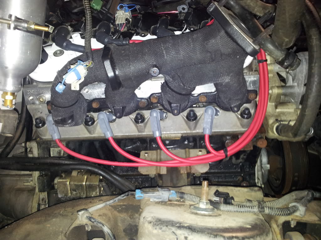

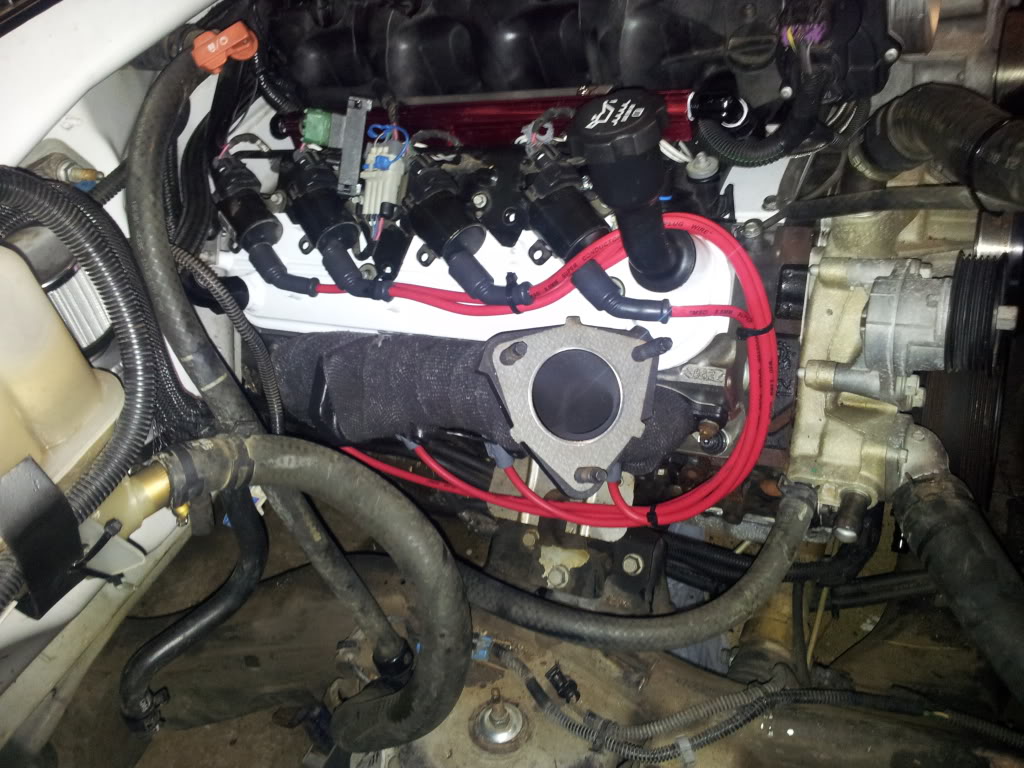

I bought the MSD build your own wires
This is exactly what I want!!! Can you get me a part number??

Here you go
MSD Ignition 32079 - MSD 8.5mm Super Conductor Spark Plug Wire Sets - Overview - SummitRacing.com
