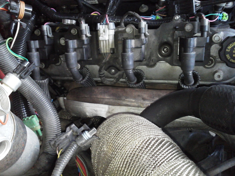

I was gonna go the "build your own wire" way but in the end I bought a set of plug wire heat sleeves and ran them in stock form. The wire isn't touching any part of the manifold but only time will tell if its gonna work or not. I'll get some pics tonight
I'd like to see this pic

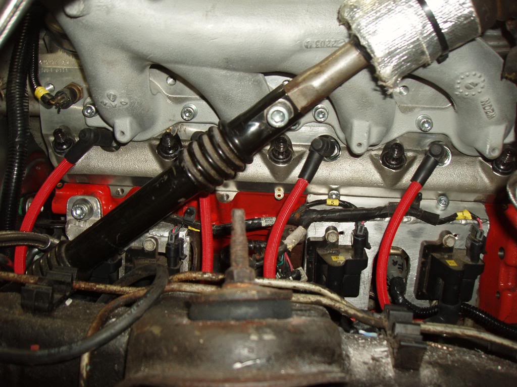

When I was running stock flipped manifolds I had the coil packs down below the header, got the idea from farm truck. Never had any issues with them.

Not the best pic but you get the idea.. I'll let you know how they work out in the next few weeks. LOL

I think if I would wrap the header it would work a whole lot better.

That will work for a little while but not for long. I had the lava heat wraps on my wires and they still burnt up real quick. I had my stock coil pack mount ziptied to the motor mount and just used stock wires and ran them up the the plugs. Got the harness extension from Nelson.

Well my plug wires burnt up!! I had 2 layers wrap on the manifolds and 3 on the wires! It'd work just fine if the wires weren't actually touching the manifolds but I guess I'll just have to bite the bullet on the high dollar custom MSD's!!
