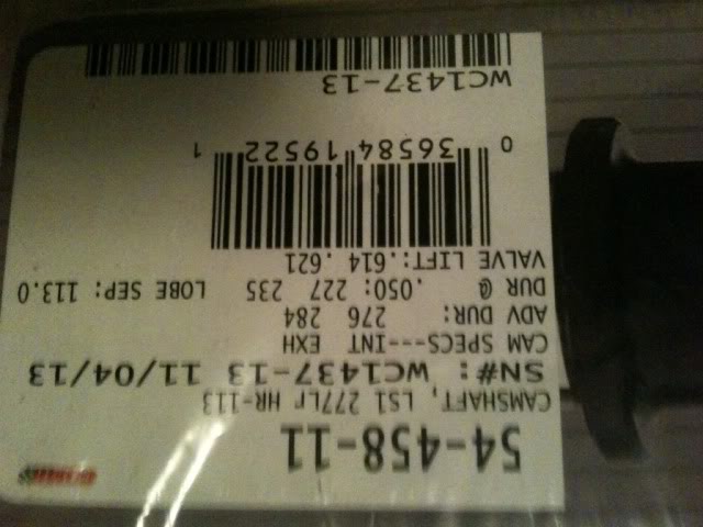

the cam specs of my cam are

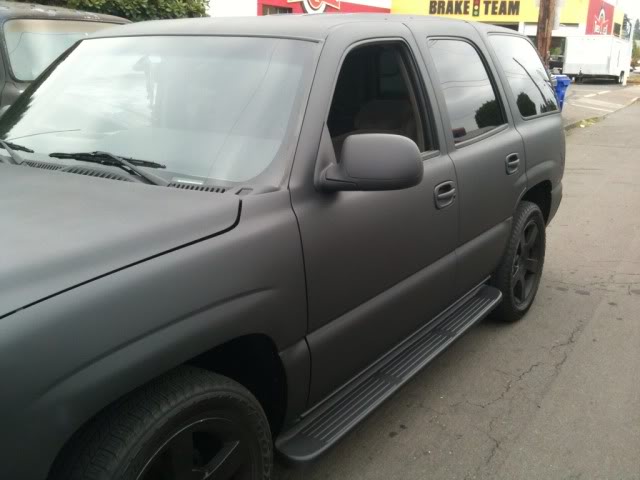

as far as weight of the truck.. I think they ring in at 5800... iirc.
but for me no spear tire, or no 3rd row, minus the 1000lbs of tools I removed. So she is about as light as I can imagine without tubing it. which Im not.
trucks lowered 2/4 and handles surprisingly well.
matte black wieght????
Ive raced everything from fullsize trucks to RCSB trucks, they cant hang with me, so I know my truck is not a regular Tahoe or as heavy as some claim. I contribute alot to a A+ tune. heck I ever raced a new challenger and had him bangin to rev limiter just trying to inch on me... Smoked a Nissan 350, Till he came back on top end only to a length (heck even that particular run in I had a stock 80e stall) Maybe everyone who ran with me has been playing with me. lol

knowing me Im going to do a turbo, if it will work with this cam I have. with the l92 heads, I should make even more hp as I go FI...... the cam was specs by Comp for this application NA. That cam is for L92 heads and Cathedral heads. From what I research turbo and cams, seems like nothing is wrong with this cam.

With what you're wanting I would go with what Kyle said. Turbo all the way for roll racing no question! Wouldn't even consider anything else for that. The cam is big and not needed with a turbo but I wouldn't change it. The inj. won't give you a lot of room for much boost. Fun project, I love a sleeper. Kickin' peoples asses with a Tahoe!
