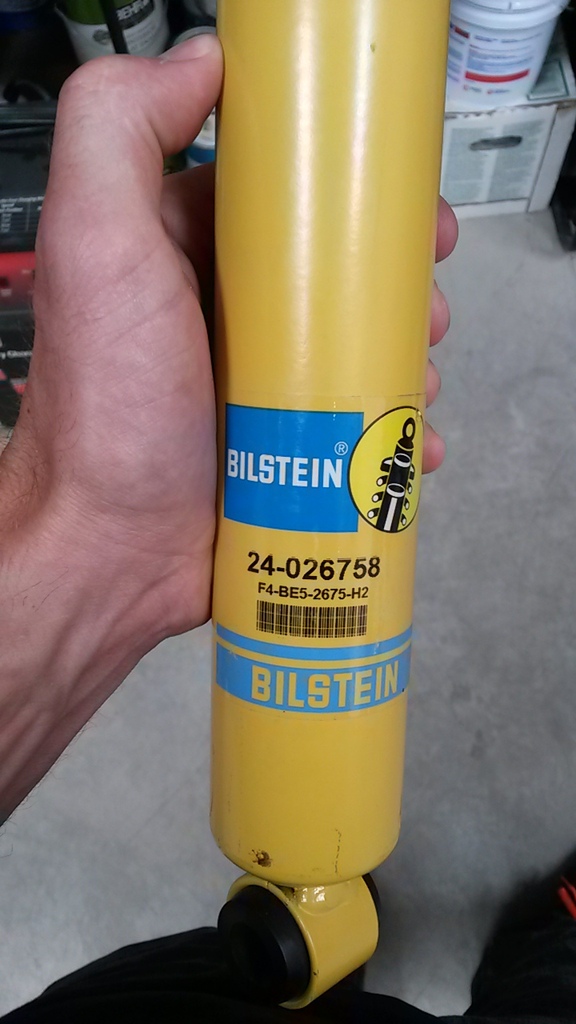

I have some bilstein 24-026758 laying around i end up not using on other toyota truck (they messure 12 1/4" compressed and 18 3/4) extended)

I called calvert racing after i read possitive things about them in here and according to maesurments they recommend p/n: CR22150 wish has more upper movement space then down, the guy @ calvertracing told me our truck move up when they launch and i always tought they compressed down
according to that info the bilstein are way to short
