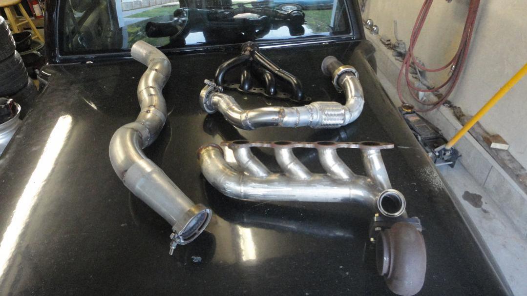

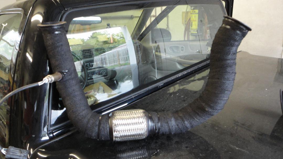

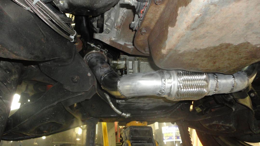

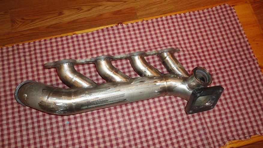

where are people locating the second o2 sensor on the single turbo log setups? (similar to KB Racing)
if i put both on the crossover, wont they be mainly reading only one bank?
i have a third o2 in my down pipe for my wideband...
this is my hot side,
Attached Thumbnails o2 sensor location on log manifold single turbo setup...-small4.jpg   o2 sensor location on log manifold single turbo setup...-s.jpg   o2 sensor location on log manifold single turbo setup...-ss.jpg   o2 sensor location on log manifold single turbo setup...-small.jpg

Mine is right below the turbo flange on the log. It is a kbracing log so I am sure a lot of people run it like that.

That's how mine is, also a KB kit..

There's no way to read left and right bank with a single log setup. U loose left and right bank. But the good news is reads close enough and it'll work if u put the o2 where they said above or in the downpipe near the firewall area.

In theory it should give you an inaccurate reading regardless of where you put them, but like Nelson said if you put it the bung in the log near your wastegate it will work well enough to keep your trims from jumping around in closed loop. It might work as well in the down pipe, but I wouldn't put it there. Save that for your wideband.
