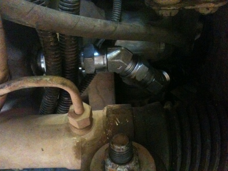

i used a -12 hose straight down from the turbo around the AC Comp and into the pan right under it.
it would take some kinda problem to stop that line up.
