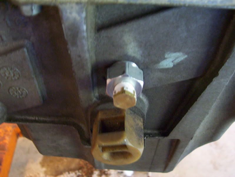

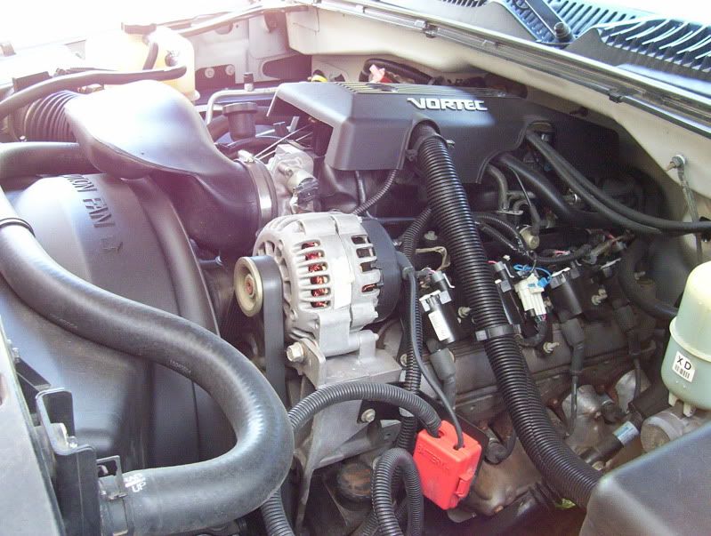

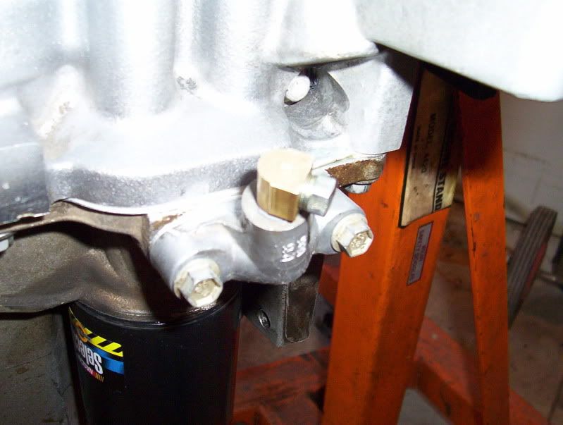

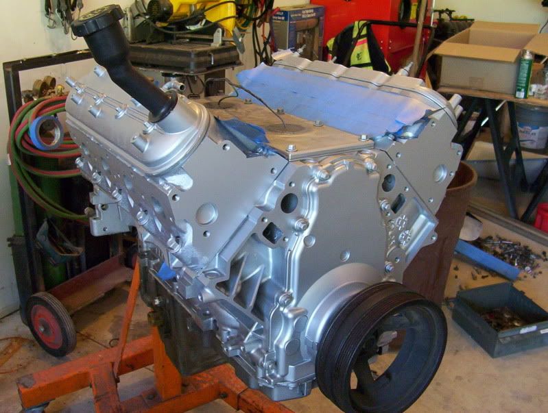

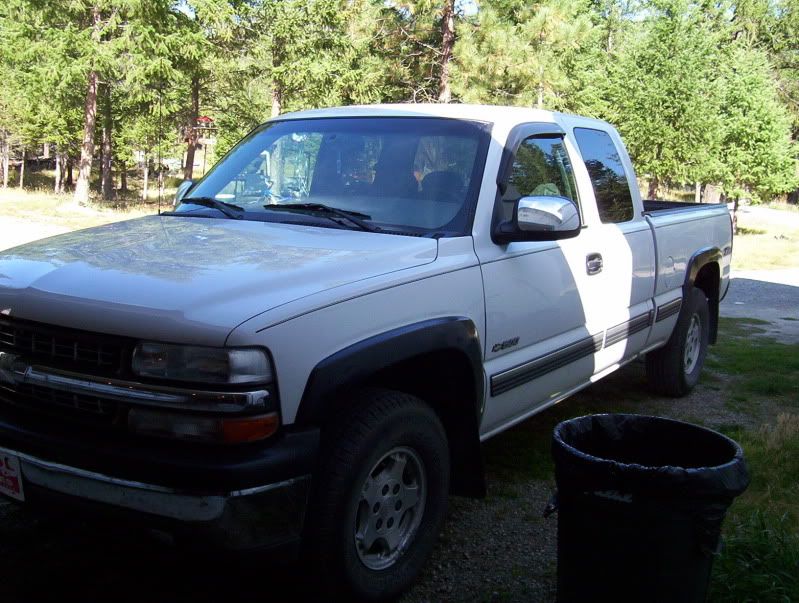

Here is the truck, engine bay, & new engine ready to go in. Paid 4550.00 for the truck & it's really nice although it's high mileage.
Note the oil feed & return fiiting hooked up with plugs installed so I can run it a while before the turbo goes in.
