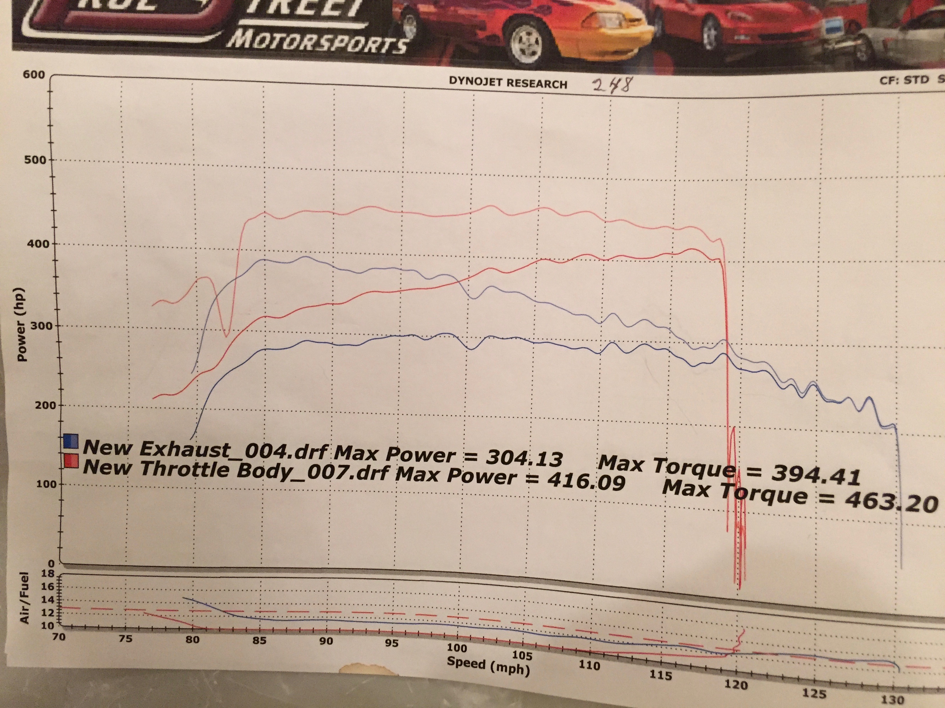

Hello again:

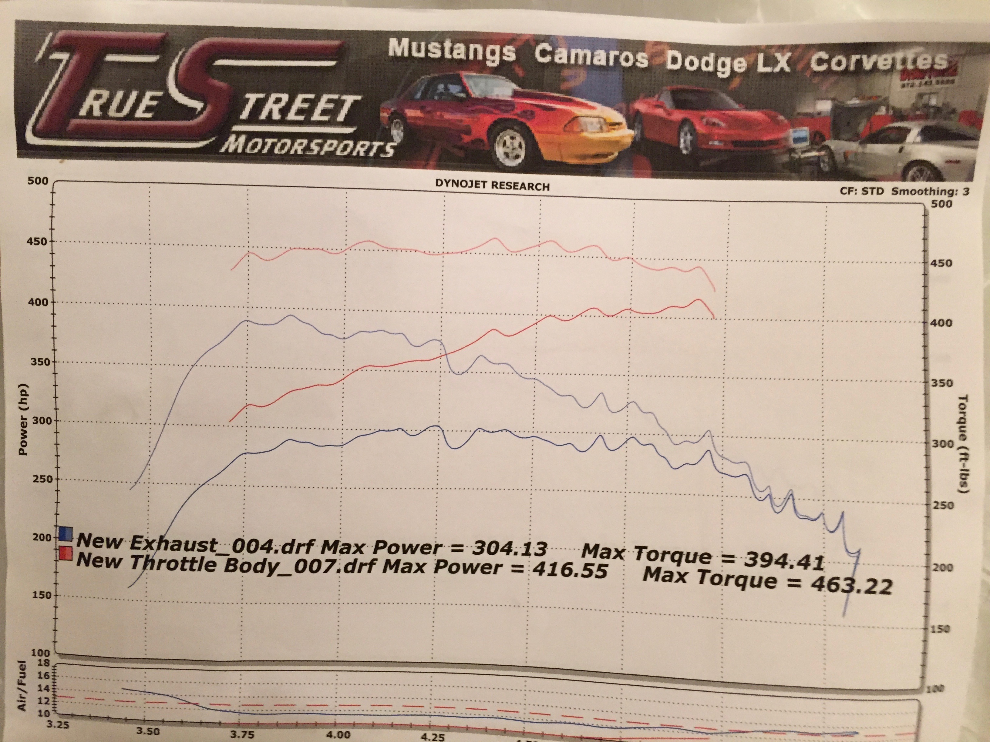

Now past the holidays, I am taking the truck in to have the engine re-dynoed WITH the Boost being monitored through the pulls.
I have a couple of additional Dyno Sheets from the last run. These will be used as a base along with the first pull on Monday.
We will be having the boost monitored across the range to finish at 5500.
I am going to try and get the Torque convertor programed to be locked up as soon as possible and run the truck through all the gears starting as low in the RPM range as possible. I think it would be interesting just to see what the Data looks like.
Anyway, a 3.0 pulley will be place on it and a larger lower pulley if the SC isn't maxed out as low as possible in the RPM range.
I was informed that the D series SC's will max out at 8-9 psi, therefore I'm going to see if it can be made to hold a roughly flat line as early as possible to max out at 5500 or as close as possible.
I will get the gauges mounted in the truck as soon as I can.
Thanks,
Ty O'Neal

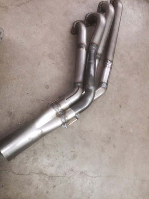

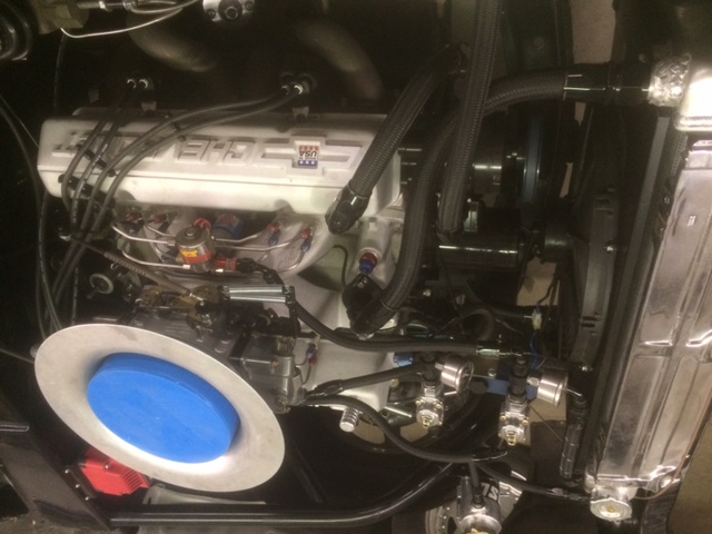

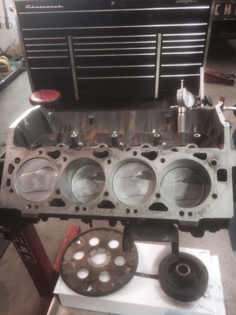

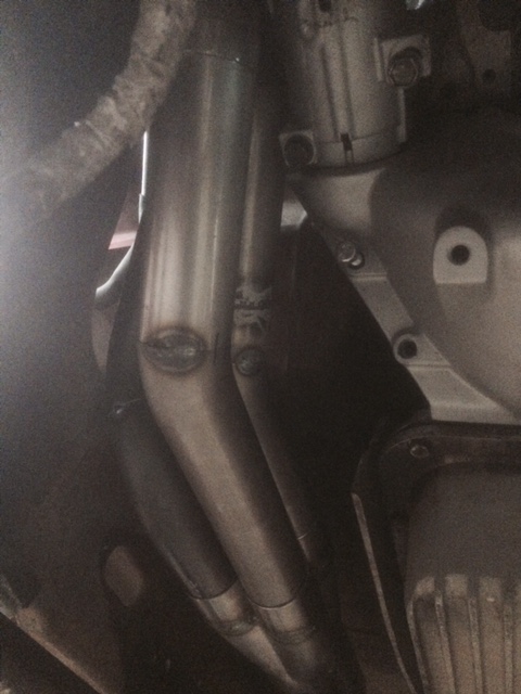

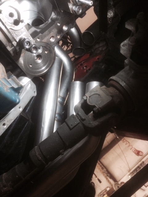

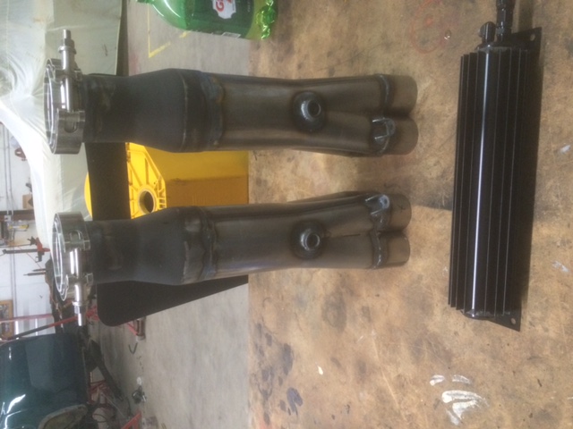

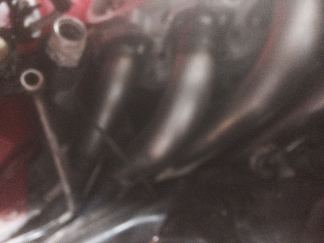

Default Update on my Truck

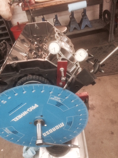

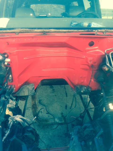

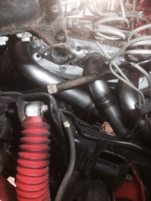

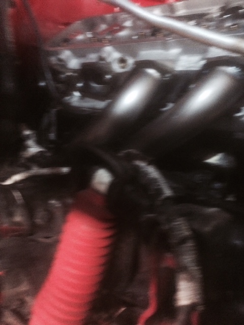

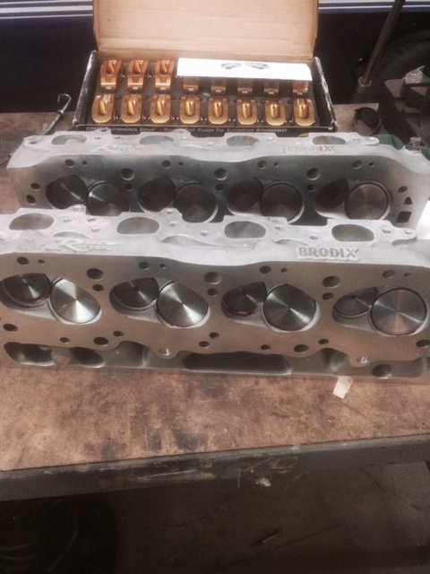

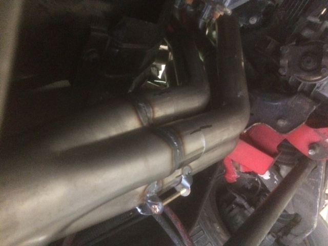

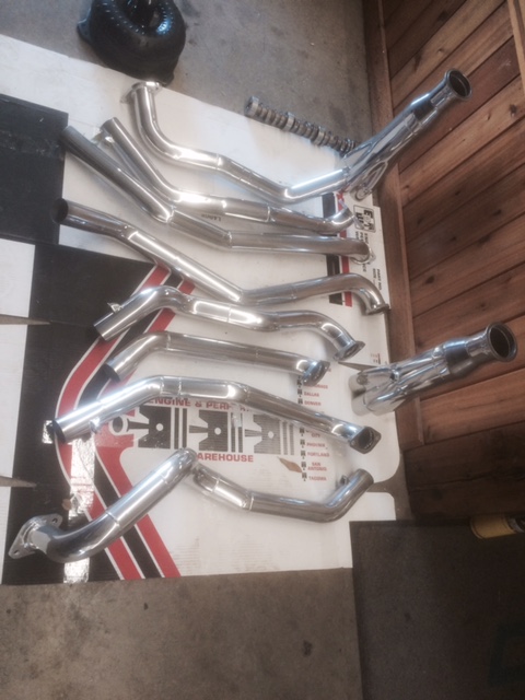

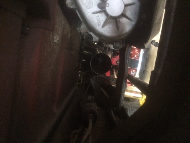

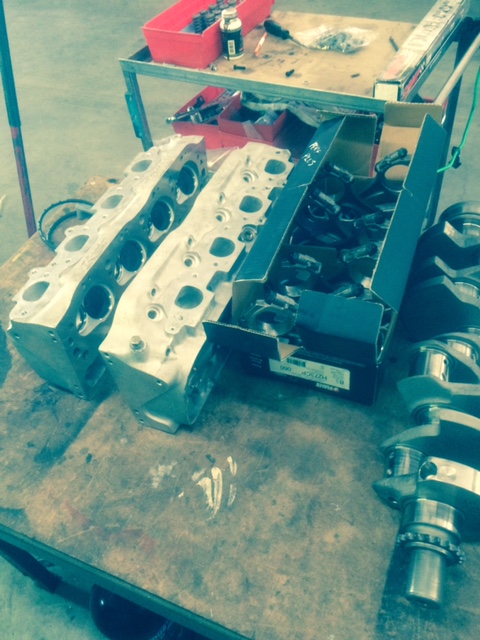

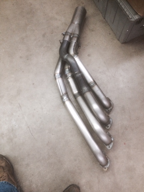

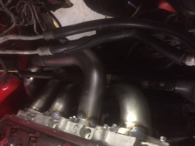

Here are some pictures of the engine being rebuilt to perform better. (Hopefully)
Any questions welcome.
Attached Thumbnails Need Help w/ Procharged HO 502 '97 K2500-img_2543.jpg   Need Help w/ Procharged HO 502 '97 K2500-img_2501.jpg   Need Help w/ Procharged HO 502 '97 K2500-img_2540.jpg   Need Help w/ Procharged HO 502 '97 K2500-img_2542.jpg   Need Help w/ Procharged HO 502 '97 K2500-img_2509.jpg

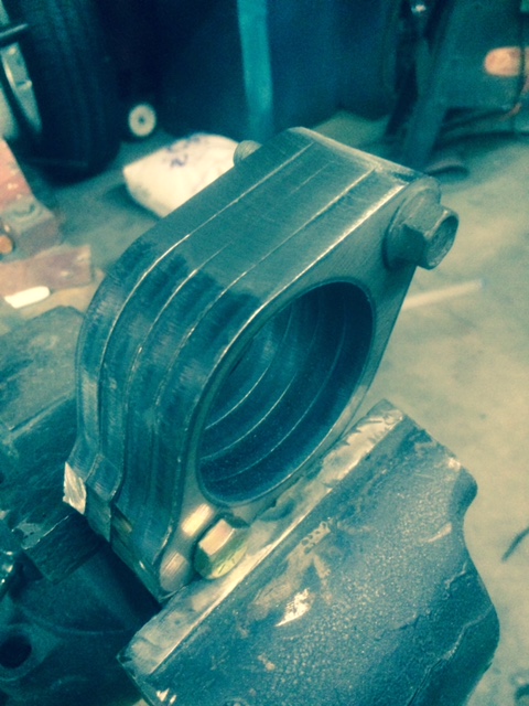

Default Additional Pictures
Here are more:
Attached Thumbnails Need Help w/ Procharged HO 502 '97 K2500-img_4104.jpeg   Need Help w/ Procharged HO 502 '97 K2500-img_3877.jpeg   Need Help w/ Procharged HO 502 '97 K2500-img_5905.jpeg   Need Help w/ Procharged HO 502 '97 K2500-img_9112.jpeg   Need Help w/ Procharged HO 502 '97 K2500-img_6706.jpeg

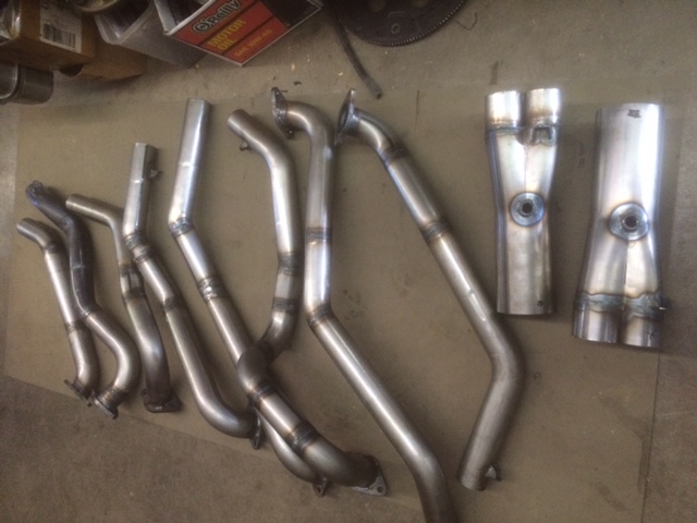

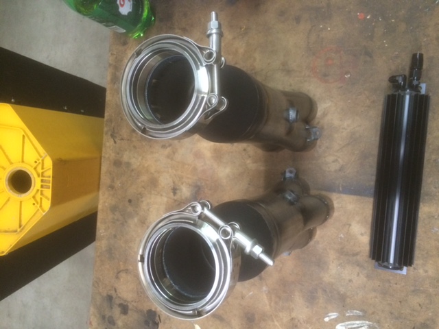

Default A few more
The rest:
Attached Thumbnails Need Help w/ Procharged HO 502 '97 K2500-img_2382.jpg   Need Help w/ Procharged HO 502 '97 K2500-img_2383.jpg   Need Help w/ Procharged HO 502 '97 K2500-img_3224.jpeg   Need Help w/ Procharged HO 502 '97 K2500-img_5976.jpeg   Need Help w/ Procharged HO 502 '97 K2500-img_2576.jpeg

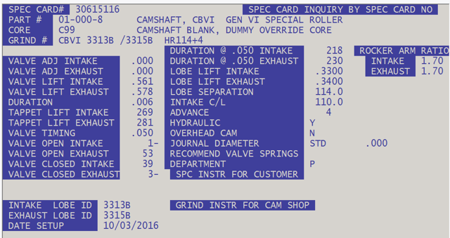

Default New Cam Card
Here are the SpecsI think this will be a much improved Item from Stock)
Attached Thumbnails Need Help w/ Procharged HO 502 '97 K2500-new-suburban-cam-card-specs.png
