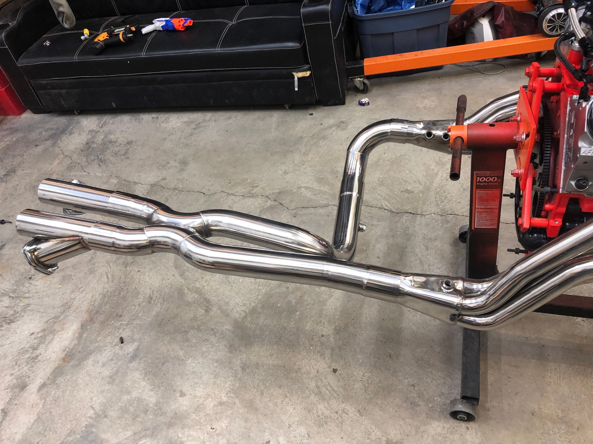

Got some exhaust parts in, just waiting on the mufflers to finish it. All the connections will be cut and V-bands welded in. Also waiting on the built transmission, should be done this week.

Everything looks good!
I'd like to hear the specs. What compression? What cam? What fuel? How much boost are you hoping to run?

Cam spec is: 223/246 .610/.600 117+6
Piston are Wiseco -3.2cc I haven't done the math on the compression compared to the stock pistons I took out.
I am running 91 octane....that's what the option is up here in Alaska for pump gas, I will be running meth.
I am shooting for 14psi.
