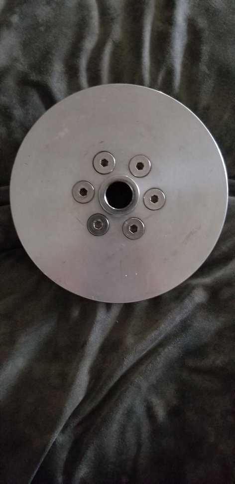

If your running a trailblazer power steering pump, I have a 8 rib pulley.

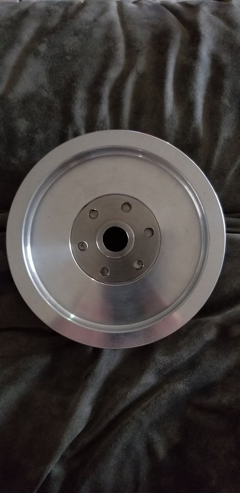

Let me measure it at work tomorrow and I'll let you know. Here are some pictures, itsfor a trailblazer ss
