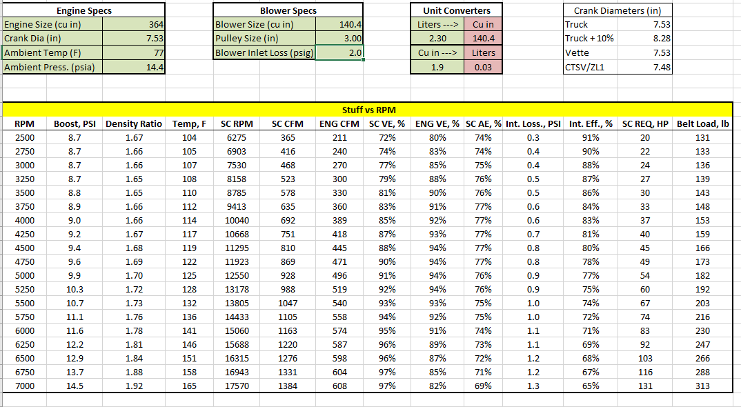

But based on the weight and the times you are showing, I think the truck is close to correct. Could it do a little more, yeah probably. but you aren't gonna gain a half second with some major thing you are missing or something. The 2 bar map will let you log boost even if you don't have a gauge and you will know how much you are making. That will be a big help on determining power. You can try out the boost calculator excel sheet that I attached here. Its pretty close if you enter the information correctly. I put in some guesses and added the info you told us. 2.3 whipple, with a 3" pulley. I assumed a stock truck balancer. It shows you should be running 8 to 10 pounds. That 6.0 made 335 HP stock at the crank. assuming 15psi would double HP, which is pretty close, then each PSI of boost is worth 22.33 HP. So you gain 178.66 HP to get a total crank HP of 513.66. Run that through a calculator and you get a 13.5 at 105 mph. Which is damn near nuts on because thats what my srt10 did with near identical numbers.
Given that you are running a 14.3 I am going to guess that you are making less boost than you think. Blowers are very sensitive to pre-rotor restrictions. Look at your intake tract and see if something could be a restriction. What filter are you running, what maf? stock air box? Then take a look at your exhaust. If there is a restriction there then it will mess with your HP gain per pound of boost. Also check your IAT's, if its too high the truck will pull timing and kill power to prevent damage. Increased restrictions will also increase IAT which could mean a combination of all three is effecting your truck. It is behaving like it is making about 5 PSI of boost instead of 10. All stock components surrounding your blower may be killing the gains you should be getting. Take a look at the screenshot below, and get a way to check your boost numbers. See what it should be making and how accurate that is to what the truck is doing. Then look for some well known causes as to why its not doing what you think it should.
Forgot to add that I did not create this calc sheet, another member on here did who's name I don't remember now.
