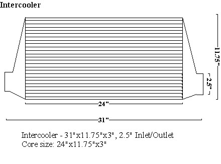

I finally have my intercooler and want to mount it asap my question is does anyone have pics of there installed along with a trans cooler ... Right now I have my current 60e with trucool and what I want/plan to do is keep the trucool installed so I can run it with the 80e and have the intercooler in front also and right now Im kinda puzzled on how or if I can make it work.. thx

Which inter cooler do you have?
Changes how the pipes are routed.
this one

so it looks likke ill be able to still run my tru-cool, i would like it behind the bumper but i have some ideal what route to take.

That pic is off of a 2010 gmc.
The core is 4" thick. Your 3" still should have enough room to go in front of your ic.
Don't worry about air flow over all.
after looking at it i did notice it was a nnbs.. yea i kinda figured the 3" would work

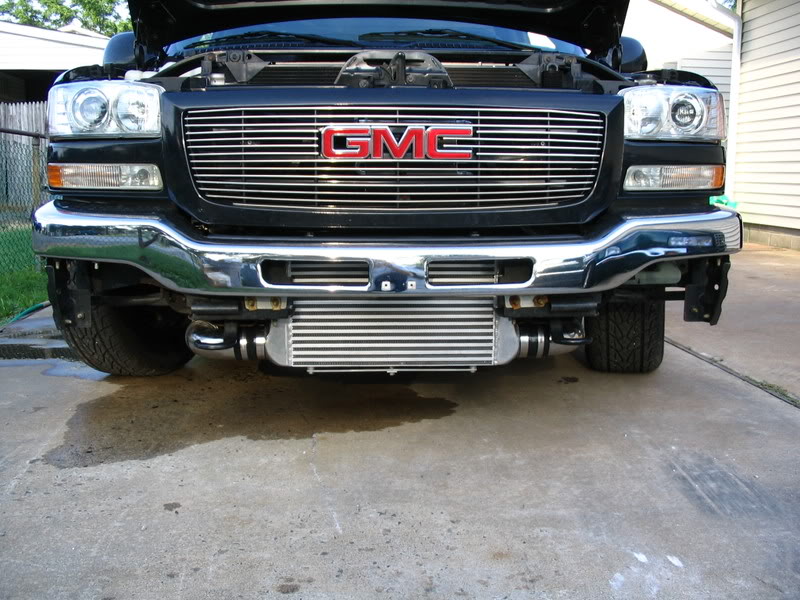

Going to be very tight around your head lights. I just noticed your trucks pic.
Might have to mount it down low.

yea that what i was thinking and find a way to route it i dont think it will be that big of a deal how im thinking

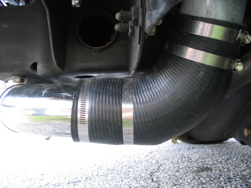

Just posted this in another thread in regards to IC and placement
When I installed it..
Both sides look the same. Tried to get them as symetrical as possible. Polished stainless where you can see, then cut and made the rest of the PC piping work with the front mount.. Forgive the dirtyness, it has been raining and snowing for a bit, have not been able to really clean under the hood. ( yes the blower has been reclocked)
