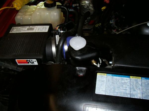

Well I don't have a air box so I mounted mine there. If you would like better pic, just let me know....

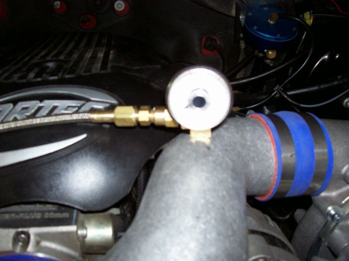

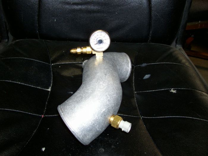

If you look under my hood you probably won't notice the meth kit. If you look hard you will see a single braided hose running to the intake tube.
Notice the braided hose running around and behind?

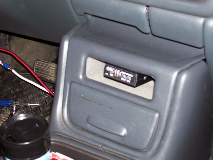

Under the front driver side wheel well you might notice the pump. All the electronics are up under the dash, hidden from prying eyes.

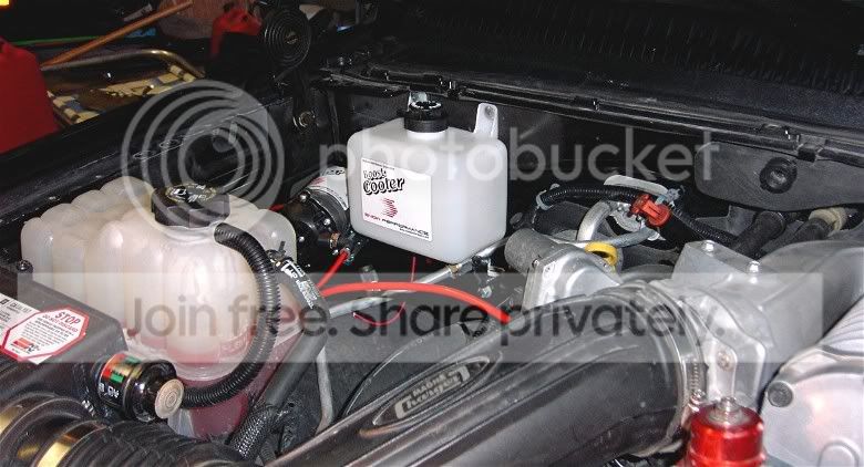

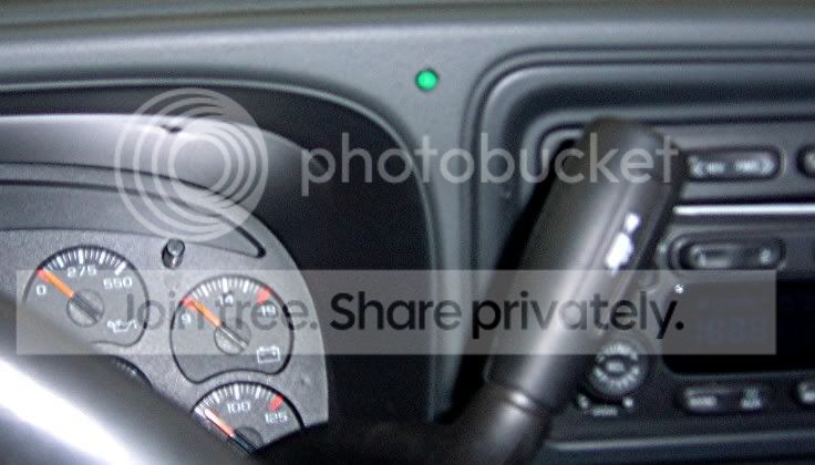

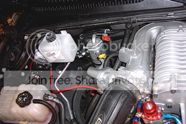

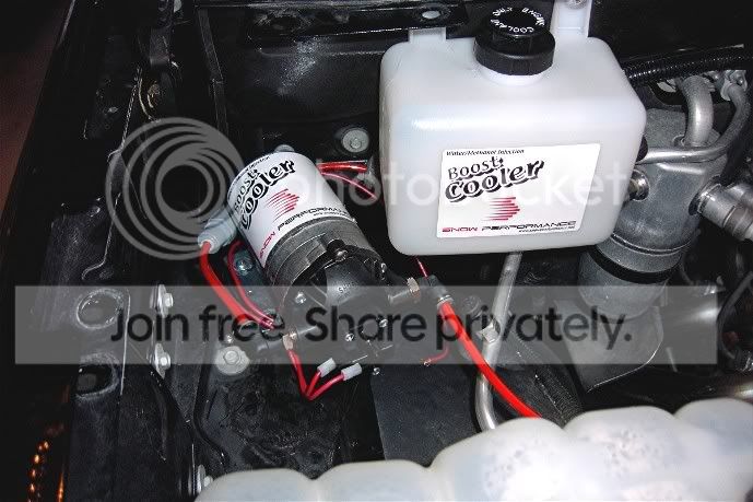

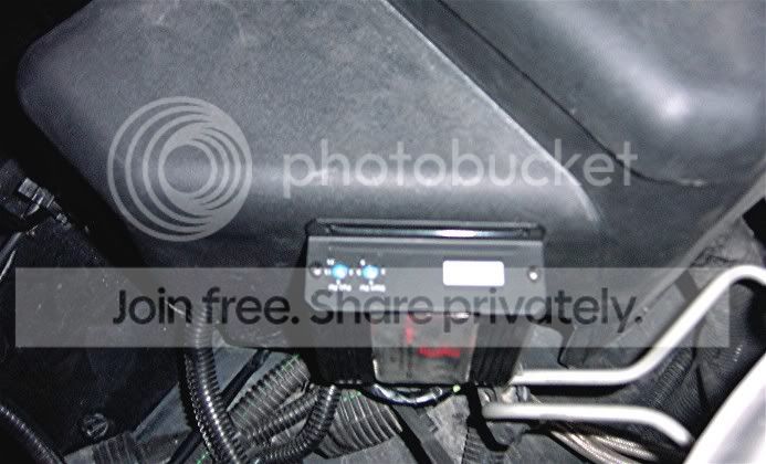

Lots of different ways to install the kits. Just follow the instructions carefully with respect to mounting heights, check valves, nozzle sizes, etc. I would like to get a larger reservoir for mine if I can find a good mounting location. 2L doesn't go very far if you have a heavy foot. I would also use braided lines if you intend to use over a 50% meth mixture.
My pump is angled to clear the hood hinge spring.
Controller.
LED

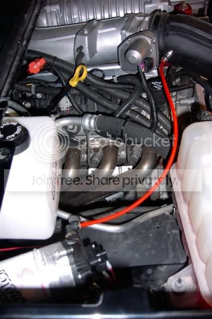

Mine was built by SMC. Come to find out a washer fluid tank from a Mitsu Evo fits the fan shroud perfect.
Attached Thumbnails meth injection guys CHIME IN!!-meth.jpg   meth injection guys CHIME IN!!-meth4.jpg   meth injection guys CHIME IN!!-meth6.jpg   meth injection guys CHIME IN!!-meth8.jpg
