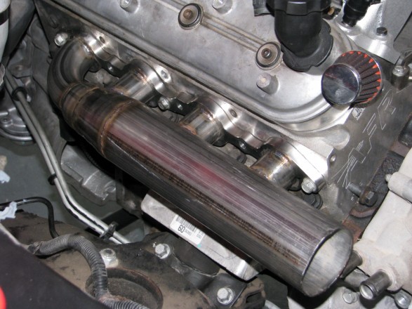

Here is mine. Stainless steel log style. Can't take credit though. Someone else built them.

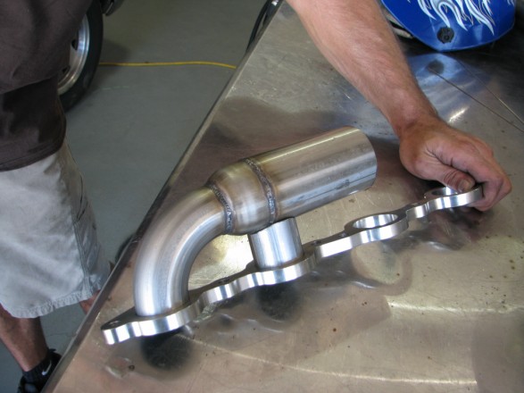

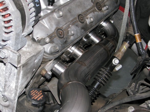

Pretty simple to build log headers, here's a couple pics to get you started.
Good looking setup. Do you got any closer pics ? Thanks
Thanks for the pics very helpful. Any noticeable difference between stock cast or cast header ?
