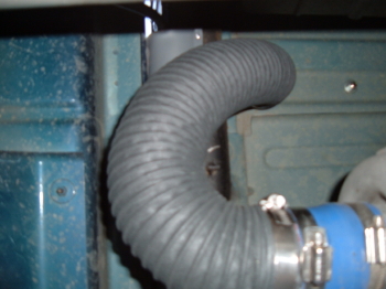

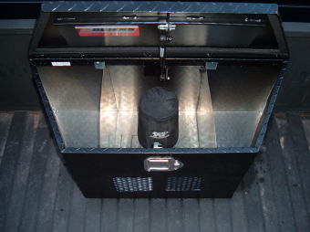

Not sure if this is an option for you. I saw about a 30 deg drop with the IC install. The meth is what really drops it. I went from 130 deg to 95 deg full boost run on a 90 deg california day. This is with the meth and IC.
Attached Thumbnails Intercooler Questions-2004_1105image0001-2-.jpg   Intercooler Questions-2004_1213image0002-2-.jpg   Intercooler Questions-2004_1213image0004-2-.jpg   Intercooler Questions-2005_0816image0001-2-.jpg
