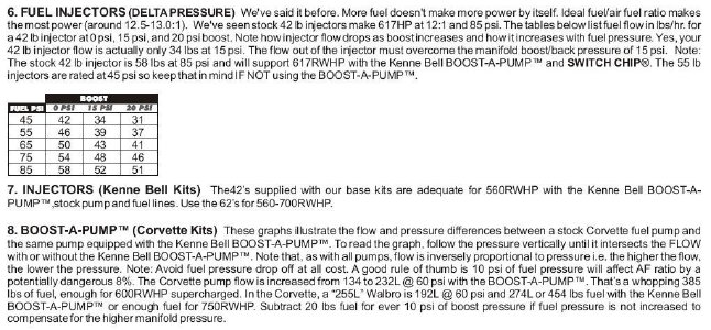

Originally Posted by TurboBerserker
700rwhp on 42s... Hmmm. Don't but it
On a 2wd (so assuming 800 flywheel), 80% IDC = 65lbs/hour (rated at 43.5psi) on 58psi of FP. Now meth will buy you a little bit, but not 23lbs/hr... As I understand them, boost-a-pumps can't raise your fp, just keep it steady, so they are no help in this.
I ran my 600rwhp setup (awd, so it was around 800 flywheel) with an intercooler and meth and didn't have enough injector with 60lbers to turn it up much more (and ruined the run with a small fire
). Oh yeah, twin 255lph walbros too. Granted I didn't run two meth injectors like Jim did and didn't get a chance to crank up the meth as high as Jim did, but still. I did have a street meth tune in there (meaning I tuned the meth controller on the street).
42lbers are TINY injectors for boost guys. TINY as in the bare minimum...
And 14psi on an LQ9 is probably a dead LQ9 Cody (unless you are doing internals). Sooner or later anyway. It's been a couple of years but we did some gazintas on SSS and figured 15psi is the bang limit on the stock LQ9. I personally think 12psi on an LQ9 is asking for trouble -- you need a perfect tune every second your at 12 psi... No room for heat, overboost, etc, although its probably worth close to 80-100hp on as STS.
On a 2wd (so assuming 800 flywheel), 80% IDC = 65lbs/hour (rated at 43.5psi) on 58psi of FP. Now meth will buy you a little bit, but not 23lbs/hr... As I understand them, boost-a-pumps can't raise your fp, just keep it steady, so they are no help in this.I ran my 600rwhp setup (awd, so it was around 800 flywheel) with an intercooler and meth and didn't have enough injector with 60lbers to turn it up much more (and ruined the run with a small fire
). Oh yeah, twin 255lph walbros too. Granted I didn't run two meth injectors like Jim did and didn't get a chance to crank up the meth as high as Jim did, but still. I did have a street meth tune in there (meaning I tuned the meth controller on the street).42lbers are TINY injectors for boost guys. TINY as in the bare minimum...
Good Point - I wouldnt want to rely on meth to make up the difference - I would need at least 60's to get to 700rwhp and might as well spend the money on the 98's. I think the walbro 255lph should be alright with the voltage booster, but your're right about the 42 pounders being too small.
I attached a good article from the KB website.
Thanks for that pic -- that confirms what I thought about FP -- the boost-a-pump increases the volume (like a second pump would) and the pressure is maintained. It doesn't help the injectors side, but looks like it does help with the volume issues.
I wonder what it does to the pumps longevity? I also am wondering about the heating up the fuel issues CB and others have mentioned. Definitely I concern where I live
