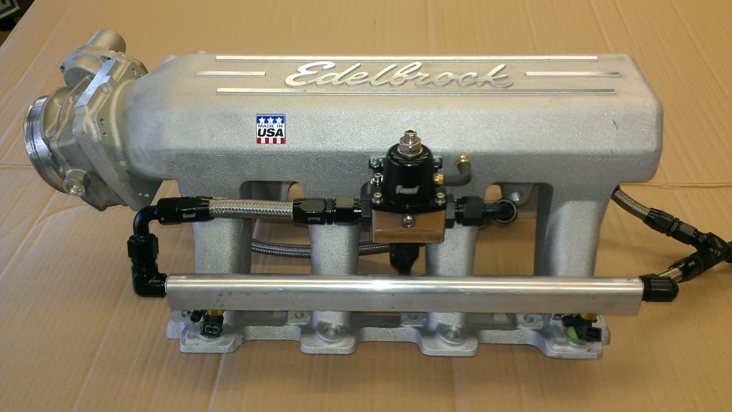

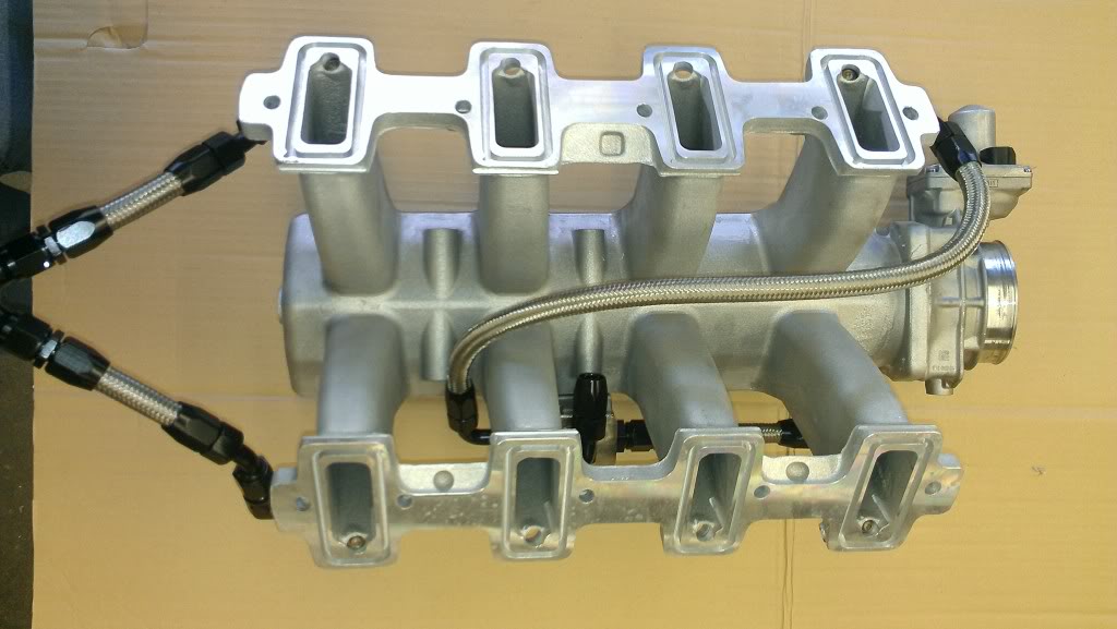

I enter the back of my rails, out the front and to the regulator. I have always thought of the old law that as speed increases, pressure decreases. If you enter one rail loop around and out the other rail, there is 8 times the fuel passing the first injector than there is passing the last injector. Maybe I'm wrong, but that is the way I wanted my fuel system to supply fuel.

Thats a pretty sweet setup!
I'm thinkin more like this...Thanks smoke!
