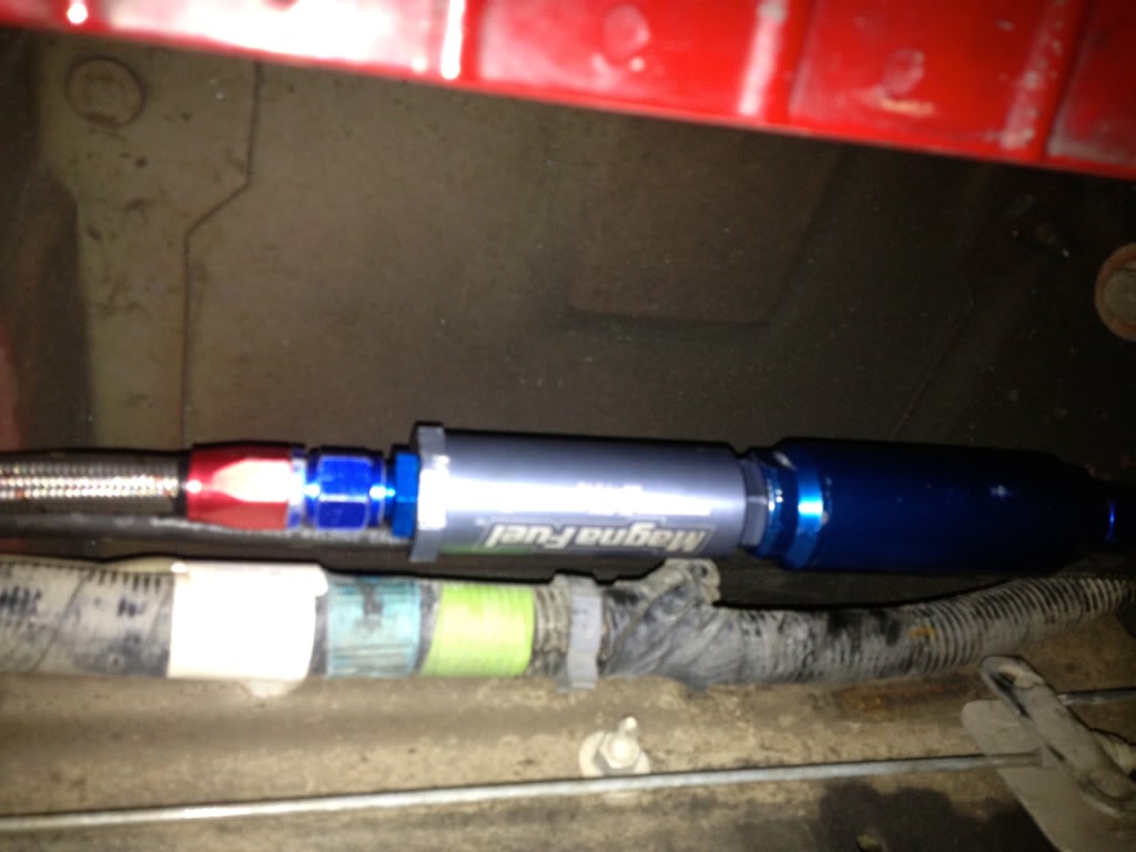

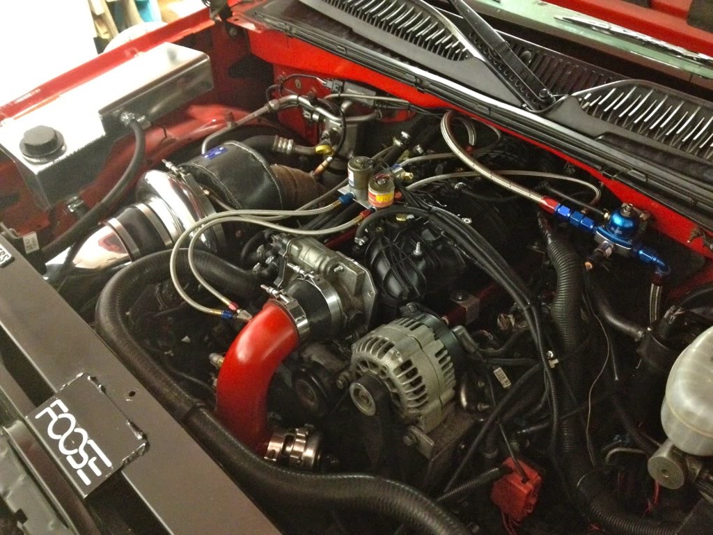

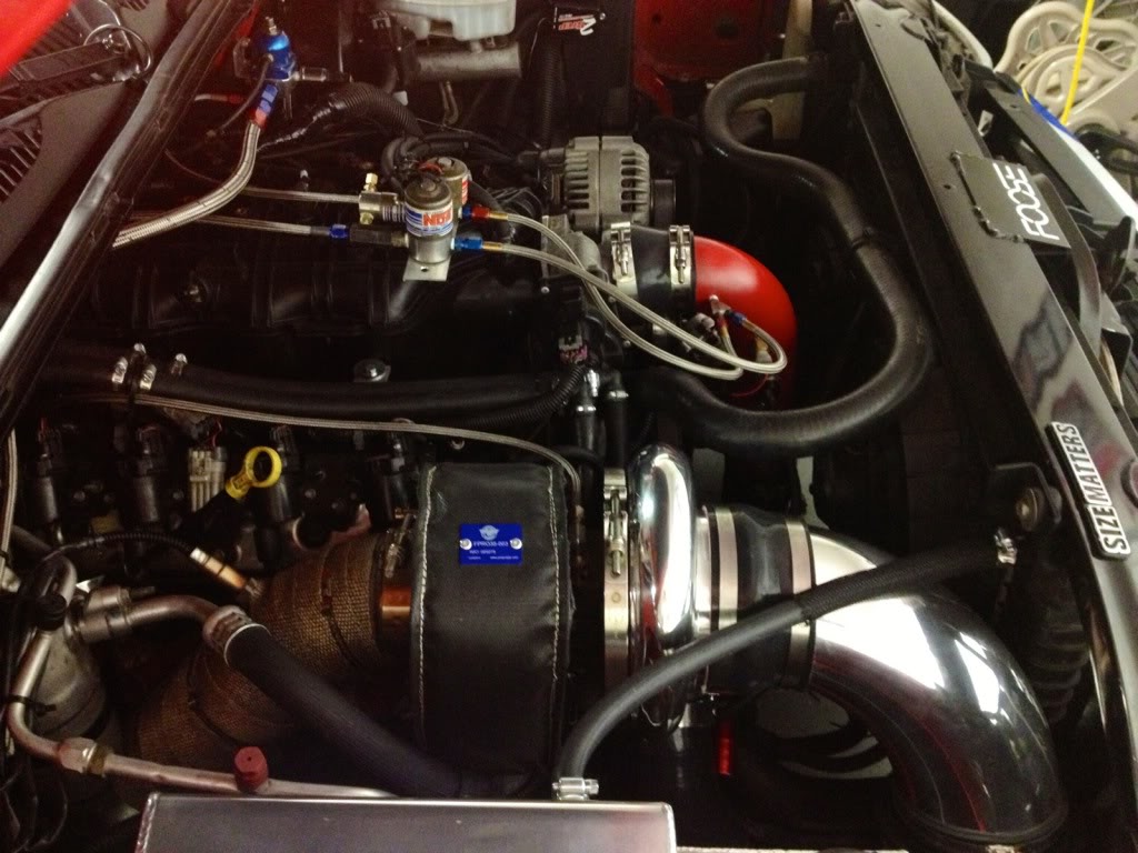

So I stopped slackin and chasing tail to work on the truck some. Got GM AIT installed (maf removed) Bosch 127lb/1320cc injectors installed replacing the 80lb's. Also removed the Boost-A-Pump as it's no longer needed. I found out two walbro 450's will overflow the stock feed line if your using that as a return line with a aftermarket (in my case fuel-lab) FPR. Lowest I could go was 65psi, installing the vacuum line made no changes. Fixed that with a hobbs switch that kicks the second walbro on at 3.5psi, so i'm running a current base of 58 confirmed with a autometer pressure switch i'm logging. Hope to keep these clean with a Jeg 100 micron steel/mess filter and megna fuel 25 micron steel/mess filter, both e85 safe.
Lastly was swapping trans/engine fluids. Hope to get a new tune started tomorrow and get it ready for the dyno on Saturday. Also need to swap in some new 7s plugs just to be safe with a .022 gap.
Honest goal for saturday.... 800 wheel (roughly 1000 flywheel). Going from last track outing and weight, i was around 770 wheel. I also figured out my nitrous was on and off the whole pass. (50 shot) I made a post on Hptuners about it, but not much help. I didn't command it, but my staging shot seemed to be on/off 1 second apart the whole pass like it was dropping signal or something. This explains some of the 15psi/134 trap/4580 weight. Hell I wish it stayed on the whole pass not just half now lol. So that said well see what it takes to make the numbers. I'll keep turning her if she takes it. Maybe a 800 tune will go 9's?! or go boom, either way it's going some where.
